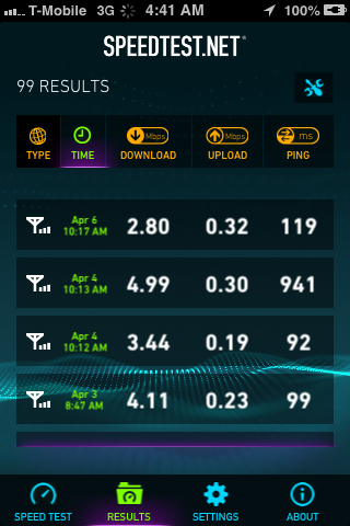

Yes it does work. Even my 3GS works pretty good on T-Mobiles new system. It doesn't get as good speeds as my 4S but it's not bad.
