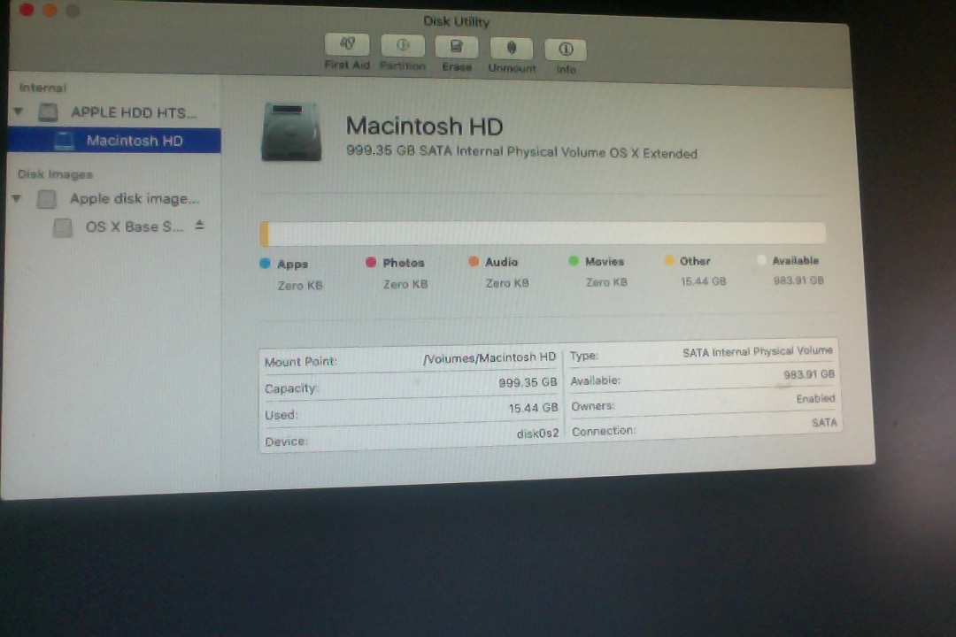

Will try again, but earlier the SSD wasn't showing up, just the HDD
Sorry about the image quality but you can see here that there is only the basic (HDD) drive and no tab offering to "show all devices" - although I had seen that option previously.
The only thing I can think of is something about the command I typed to "resetFusion" has hidden my SSD.

the picture above goes over this
@Sai22 I understand the problem—the SSD is not mounting and thus is not showing up in Disk Utility. Try going into Terminal (in Recovery) and type in diskutil list, and see if it shows up. If not, try what I have at the bottom of the post.
Please read this super carefully—the reason the SSD disappeared is because you tried to create a Fusion Drive out of something that is not supposed to be a Fusion Drive (i.e. a NON-Apple-Branded SSD mixed with an Apple-branded HDD). Next time, just keep them separate and it will be fine.
When you type in diskutil resetFusion (which I would assume is the command you typed in), it attempts to create a sort of RAID set (not necessarily a RAID set per se but sort of)—and that REQUIRES the "normal" Apple-branded hardware.
So... how to fix? Try taking out the SSD and putting it back in. I know that's a bit of work, but just see if that helps. If not, try another NVMe SSD—you might have bricked that one.

MAYBE the little connector of the blade‘s flex cable wasn’t 100% pushed into the motherboard or got loose over time.
To rule out a simple hardware cause you could re-check all connections.
edit: Although the post above seems more plausible, it doesn‘t hurt to check. Happened to my mini once.

If there is a blade in there as well, you may need to replace it as its not showing up in utility. BUT, the crashes may have been coz it was nvme and the 2014 mini may not sleep well as the firmware is old (not sure)... best to replace the spinner with a sata ssd in that case, anyways... thats fast enough.
