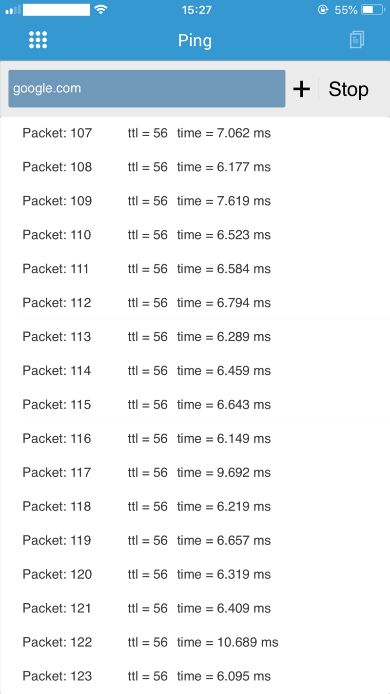

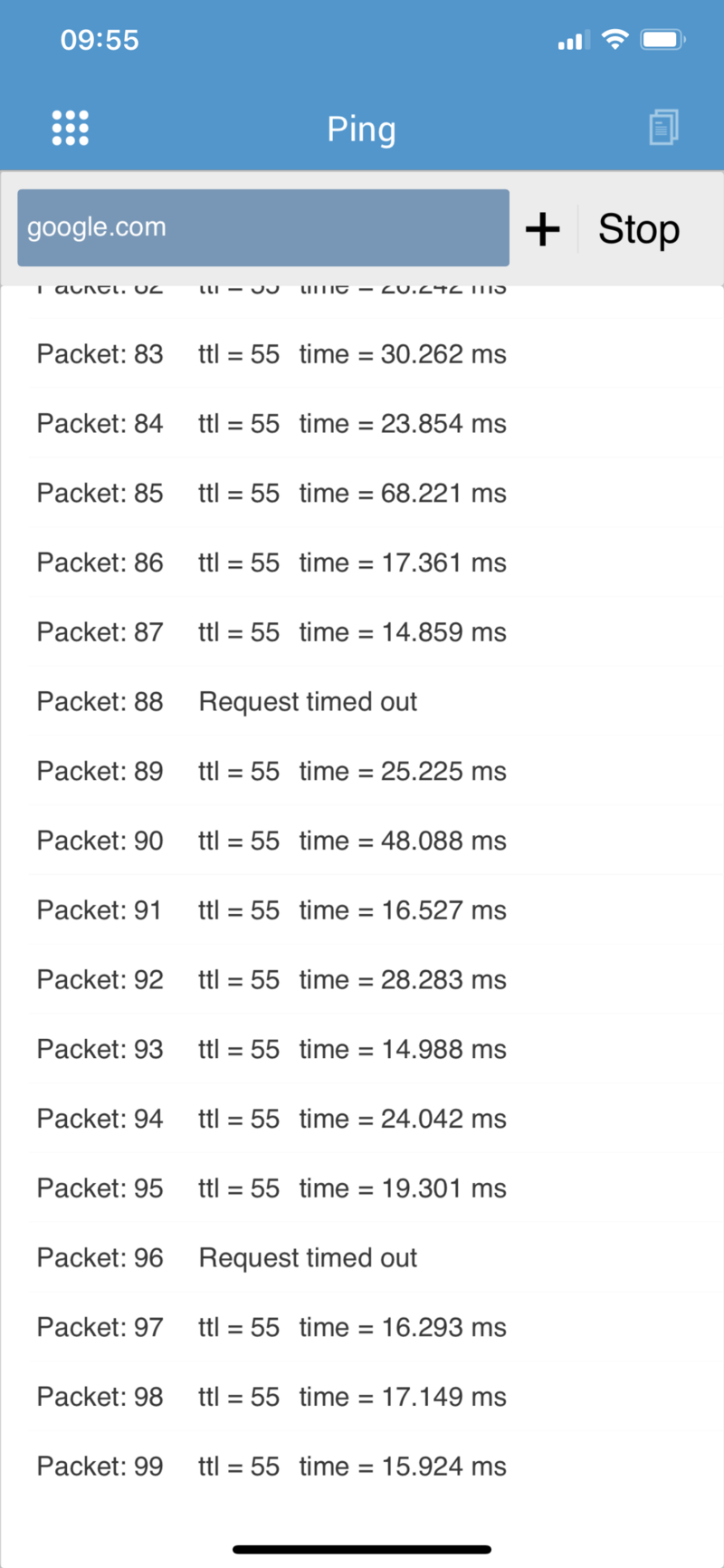

So I tested the following after I noticed that the WiFi range from my brand new iPhone 11 Pro Max seems to be worse than other devices I use with my current internet connections for years now without any issues.

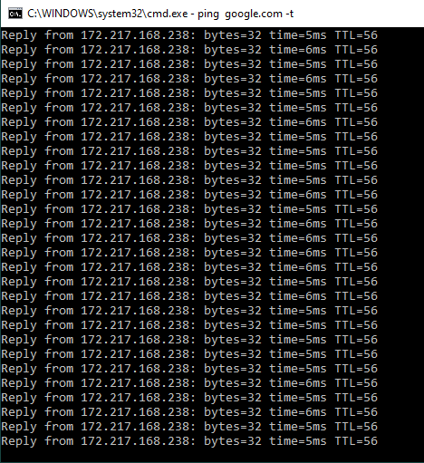

I started a ping test at the same spot (different locations and thus different Access Points and ISP’s) and time to google.com with Windows 10 laptops and ManageEngine Ping Tool for iOS.
Access Point: EnGenius ECB1750 (tested with laptop and 2 iPhones)
Qualcomm Atheros QCA9565
iPhone 11 Pro Max with iOS version 13.3
iPhone 6 Plus with iOS 12.4.4
Access Point: Aerohive HiveAp 130 (tested with laptop and iPhone 11 Pro Max)
Intel Wireless-AC 9560 160MHz
My iPhone 11 Pro Max always gives worse results and even time-outs.
I resetted the network settings to no avail.
The first Access Point (EnGenius ECB1750) I tested with is on 2.4GHz. The second (Aerohive HiveAp 130) is on 5GHz and seems to be worse, but on both frequencies it's unstable compared to any other device.
Recently I updated to iOS 13.3.1, but results are the same. Changelog doesn't mention anything to do with WiFi.
I checked that my Win10 laptop and iPhone 11 Pro Max have the same dBm (I read RSSI info from Access Point) when testing.
I also tried to do some testing with other iPhone 11 Pro Max devices at stores, but all those Live Demo Units are locked from installing any app. I was able to logon with my test-Apple ID, but downloading apps always is greyed out.
This way I am not able to test properly with an app like ManageEngine Ping Tool for iOS. I would set-up a hotspot with a third phone and then ping that gateway address.
What could be going on here? Does anyone else experience the same when testing this?

I do care about those ping times, because I found out that only my iPhone 11 Pro Max has unstable ping times and other devices don't. I started investigating this, because I notice that my iPhone 11 Pro Max doesn't seem to detect AP's in the neighorborhood as well either. From this point I try to find out if I'm the only one having this issue, because I don't like to have my phone send to Apple for nothing.
I am aware of the best practices that jschnee21 mentions and applied those.
I know about low priority for ICMP packets, does anyone have a better testing method for this iPhone?
