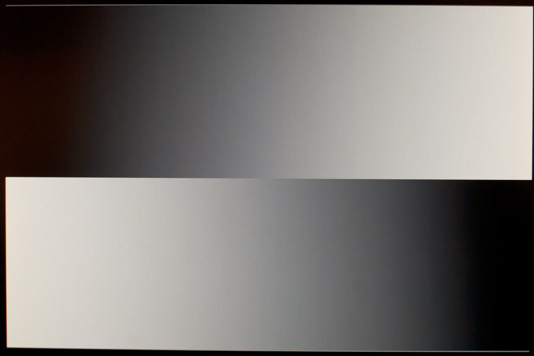

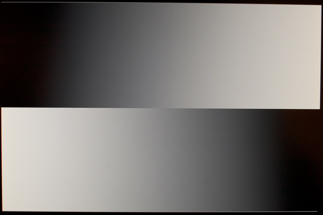

OK, so here are photos of each....
The difference may seem insignificant, but I can definitely make it out at a distance of 1.5 feet. The photo's dont render the fine gradation in the highlights so well. In other words, its worse in person.
Yes its under warranty. I wasnt necessarily looking for a replacement or whatever, I just thought they should look the same, and I wanted to find out why they dont.
Thanks
Oh, discrete is on the left, integrated on the right, and be sure to look at them at 100%
From what I can tell, they both have banding, but one is horizontal, whereas the other is vertical.
It doesn't look like the kinds of things I see with faulty graphics cards. Maybe the dithering explanation is right.
