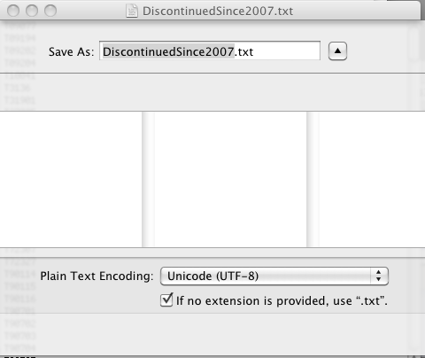

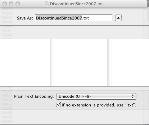

Attached are the list text files, and the Terminal results. I also included a screen capture of the UTF-8 format used in TextEdit. I'm still not getting the files to move to the destination folder. Here is the script used:

Besides using my original DiscontinuedSince2007.txt file, do I need to save that as a UTF-8 format text file (DiscontinuedSince2007UTF-8.txt), for the script to do its conversion?

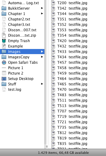

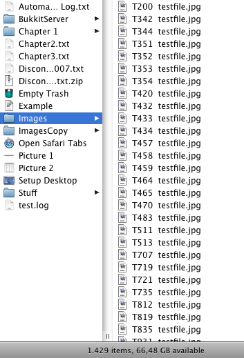

No need to save. The textutil command takes care of the conversion from UTF-16 to UTF-8. Look at the tumbnail from terminal, the converted file still has the line terminators : ASCII text, with CRLF line terminators. I tested the script with 1429 files. I attached the output of the script.
