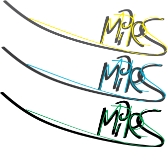

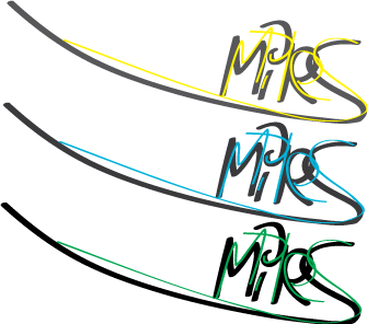

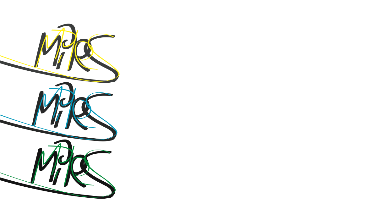

I'm new to Illustrator, and I'm trying to export an image I've made but I don't want it to export the portions I drew outside of the borders from the original image.
Does this make any sense?
I'm trying to get it to export just what is inside the box, not what I drew outside of it.
I've only been able to get it the way I want if I save it as a PDF, open it with Preview, and save it as a .png. I know there has to be a better way to do this.
The images with shorter tails on the s' are the way I would like to save it, and the images with the long ones are the only way I can.

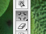

You can use "Slices" to export a certain portion of an image. The simple way of doing this is to draw a box around the area you want to export and then go to "Object->Slice->Make". Then in the export for web dialog, you can choose just to export selected slices.

Thanks! I'll try it right now.
Moto, thanks for the help.
What I meant was it made it a smaller image for some reason.
Jerryrock, that was it, I wasn't.
Thanks for that, that was my problem.
