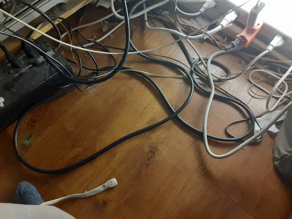

(and also to get a visual look at my system from the outside, I started a photo gallery here🙂
USB JUNGLE (FLICKR photo album)
You definitely have an interesting setup, the cables alone would drive me crazy.
