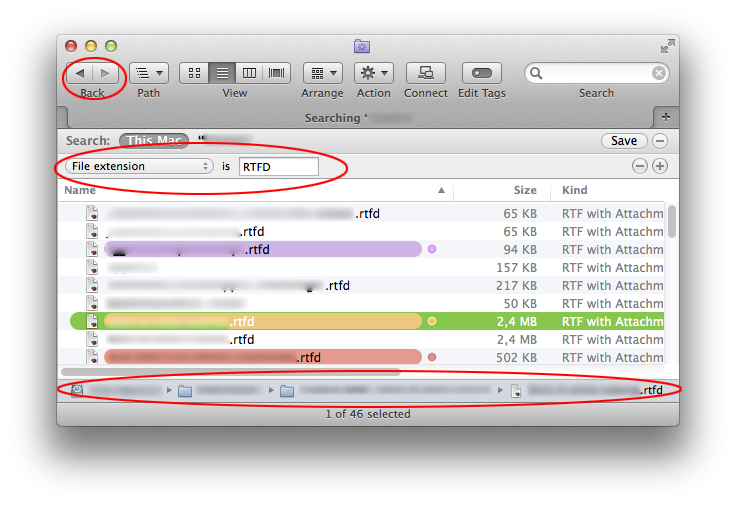

What I did was simply to use the Finder's search function to locate all files with the RTFD extension, open them up one by one, "print" them to PDF (I've created a CMD-P shortcut for "Save as PDF", so it's basically CMD-P and CMD-P again), then I zip compressed each original RTFD file in the same folder as each PDF file (so I can check the dates or revert to the original file if I should ever need that).
While being able to display all RTFD files in one Finder window, being able to access each file's folder location might not be as straightforward, but if you first click once on the RTFD file in question, then look at the file path at the bottom of the Finder window you can double-click on the file's folder which will open it up. Once you're done compressing the original RTFD file (after creating a PDF out of it) you'll want to move on to the next file, so you simply click the back arrow in the Finder window to see the list again.
