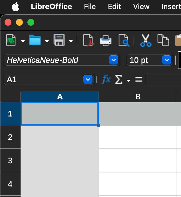

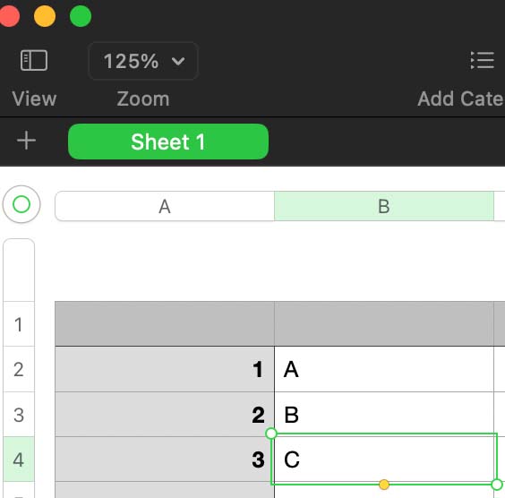

I’m sorry, I’ve just tried and it doesn’t seem to work with files created by Numbers version 13.1. It generates blank or incomplete PDFs.
I can’t get LibreOffice 7.6.4.1 to correctly open even the simplest Numbers version 13.1 files. I am tempted to open a thread to find out if others have this issue, but I thought I would check with you first to see if you have any insight into the problem.
I can only confirm that even the simplest numbers file (Basic – Blank template) doesn’t open correctly in LibreOffice 7.6.5 or 24.2.0.
Thanks for checking!
I tried to open simple Numbers files using LibreOffice on both Monterey and Ventura, so I was somewhat confident that there is an issue. However, I was surprised that I couldn’t find anyone complaining about the problem because it seems others would be regularly using this translator, and your September 7, 2023 post from above indicates the problem has been around a while.
