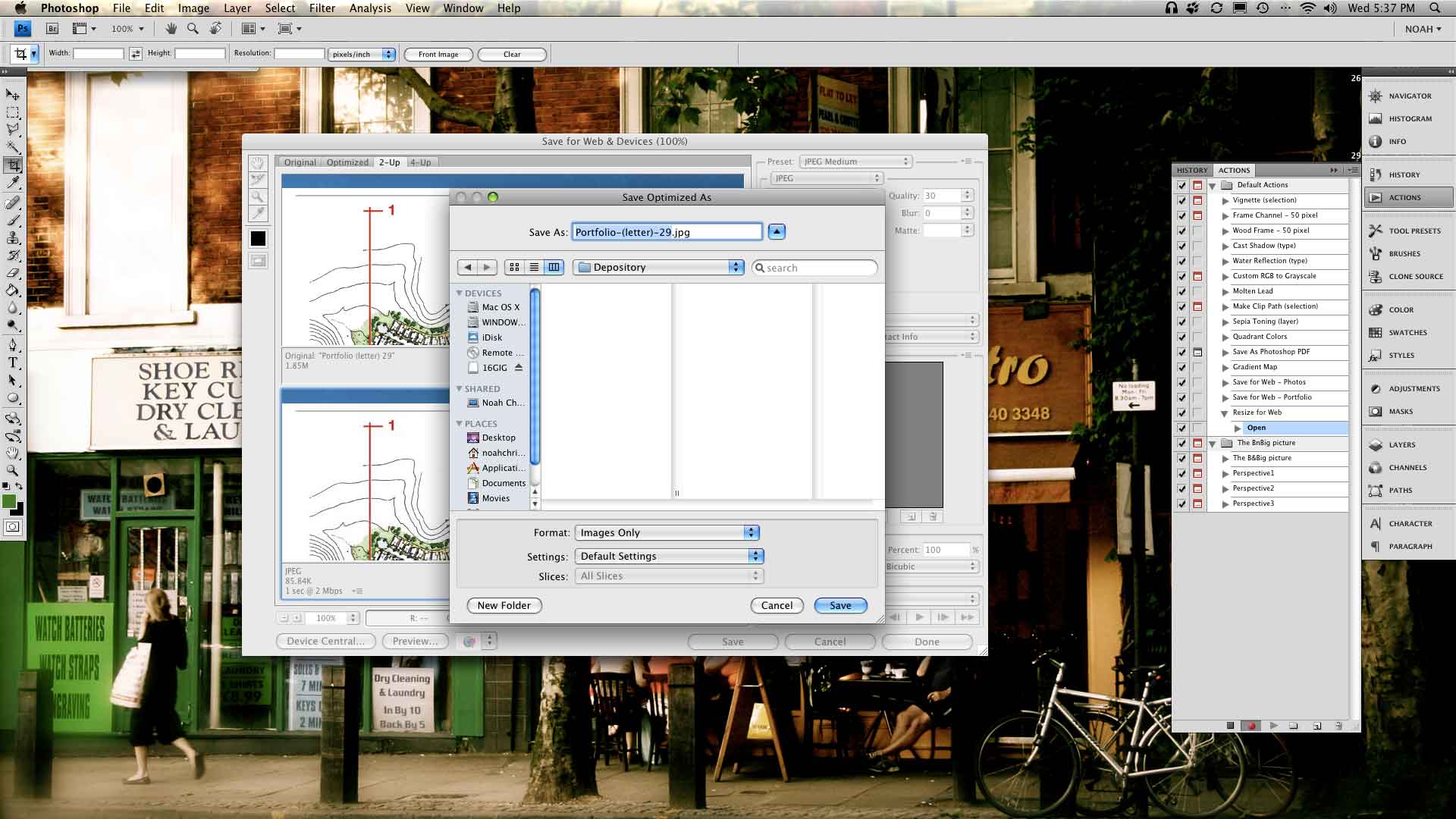

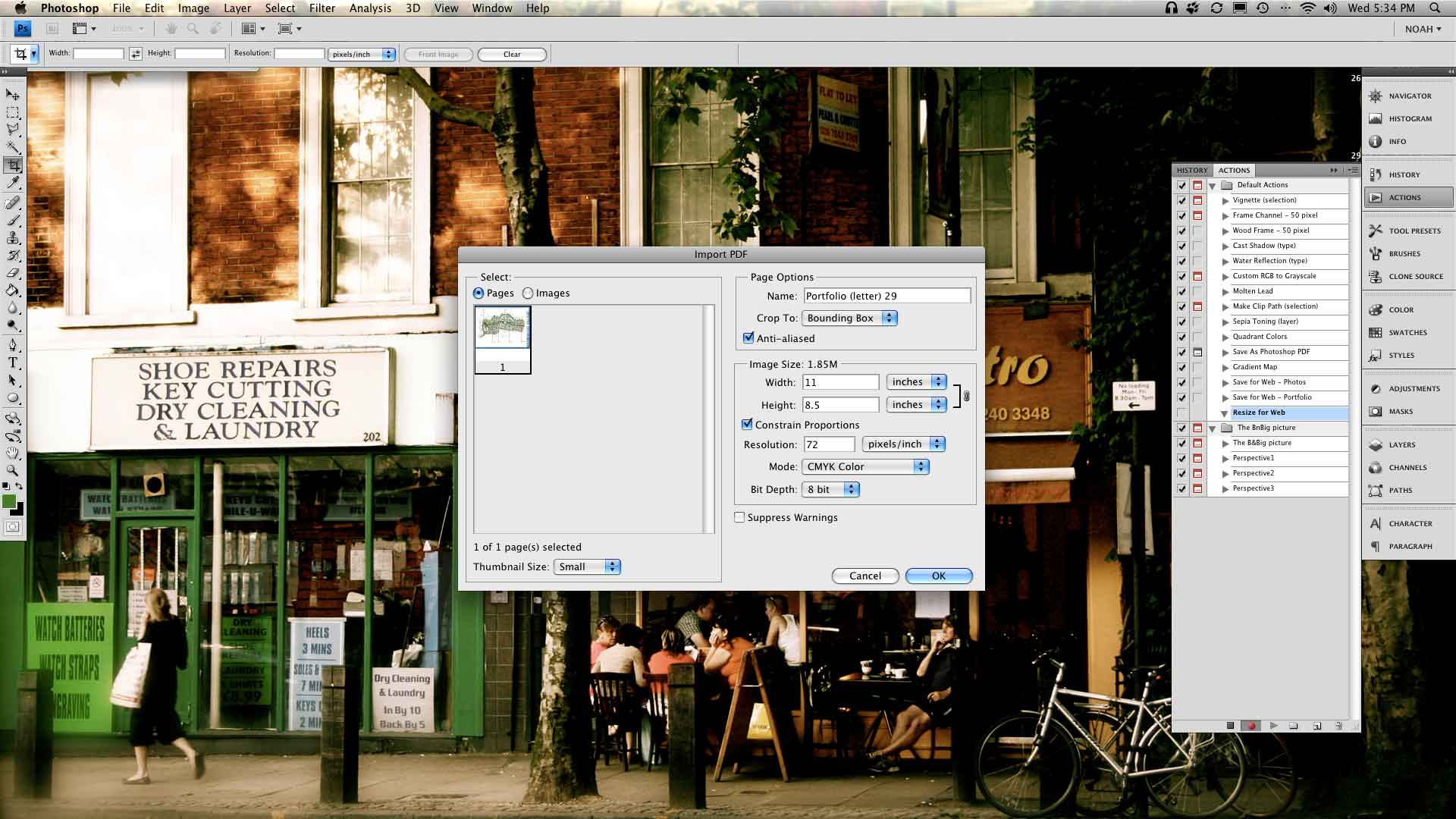

Hey there, hoping you guys can help me a problem. I'm trying to batch process a very simple Open, Save for Web, Close action that I've created to easily turn PDFs into reduced file size JPEGs. For some reason, Save for Web acts as a different beast within the action, and makes running the batch action result in a single file that constantly gets replaced over and over again by the next item being batch processed.
Regardless of what I try in the batch filename override boxes, or however I name the original file used to create the action, I always get the same result.
Any ideas of how to make Save for Web work well in a batch process? Thanks!

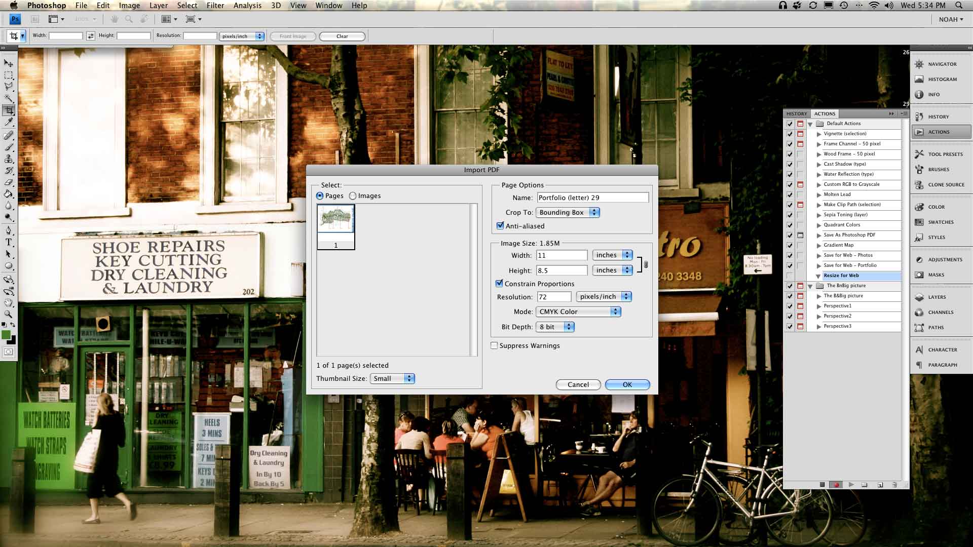

Here's a couple screenshots that illustrate the process I'm currently using.
Picture 1: With the Action recording, I'm opening the primary file.

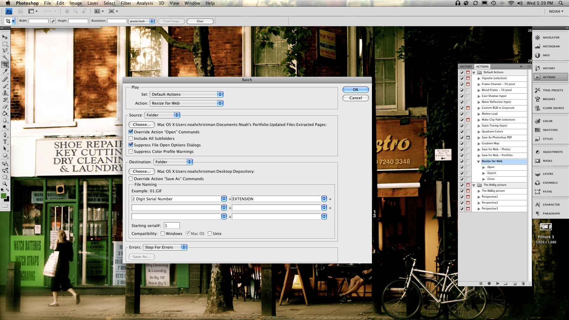

Picture 2: Still recording, Save for Web is configured how I want it.

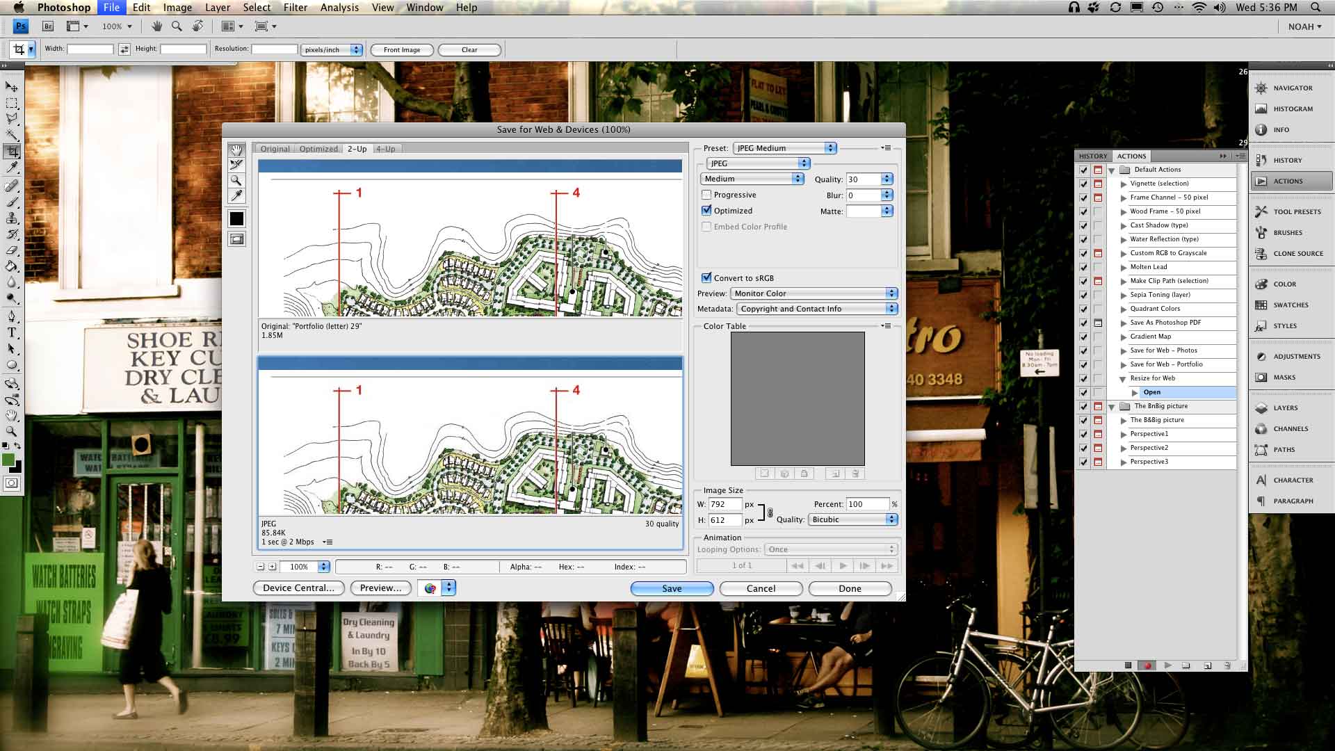

Picture 3: Saving from Save for Web as original file name.

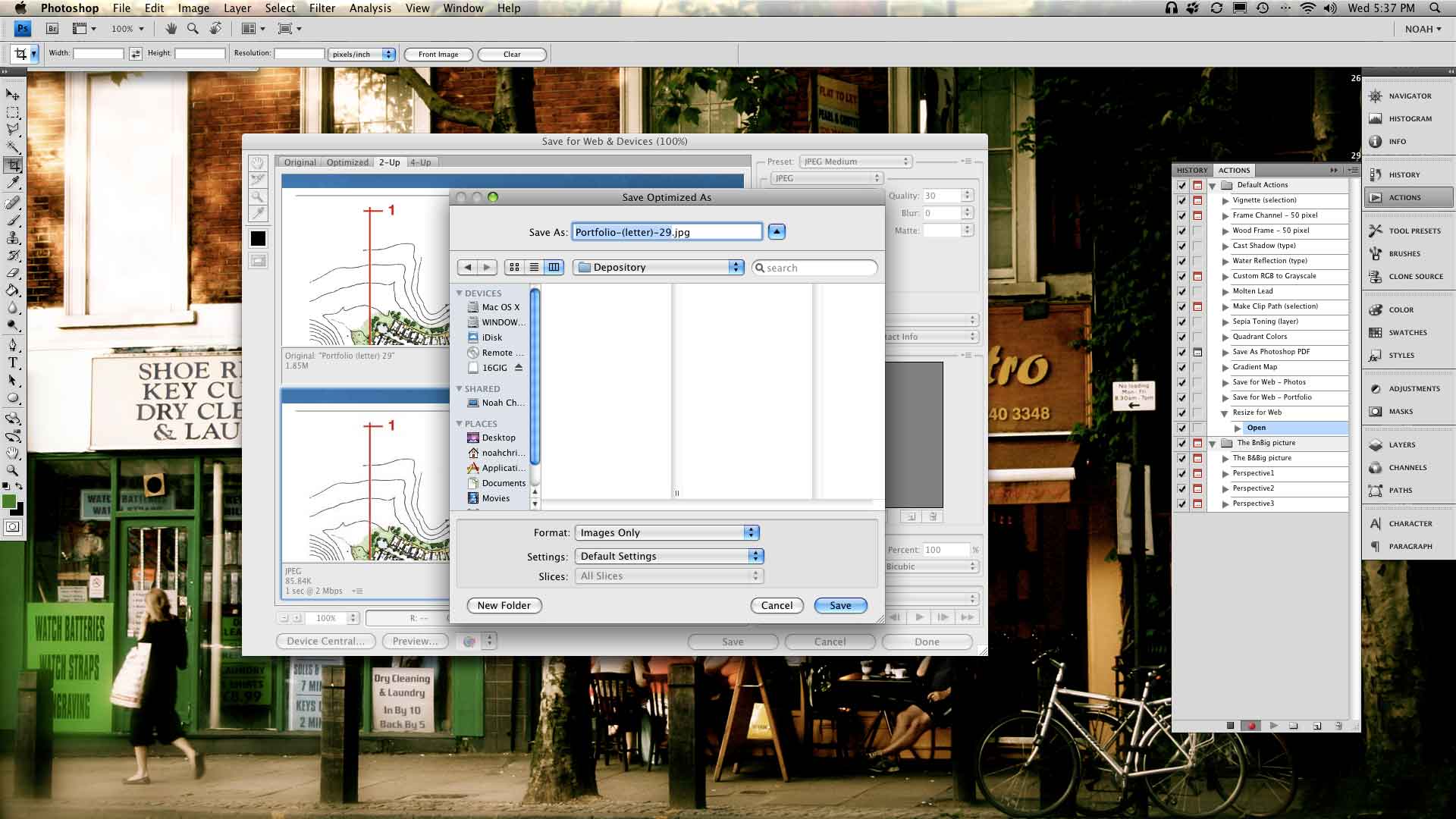

Picture 4: I've since Closed the primary file and stopped Action recording. Now I've configured the Batch process.
Once I run the process, regardless of whether or not Override Action "Save As..." Command is selected, and regardless of what I name the file during Save for Web, I always get a file that continuously over-writes itself until finished with the action (or I stop it).
Any ideas to how to fix this annoying issue?
