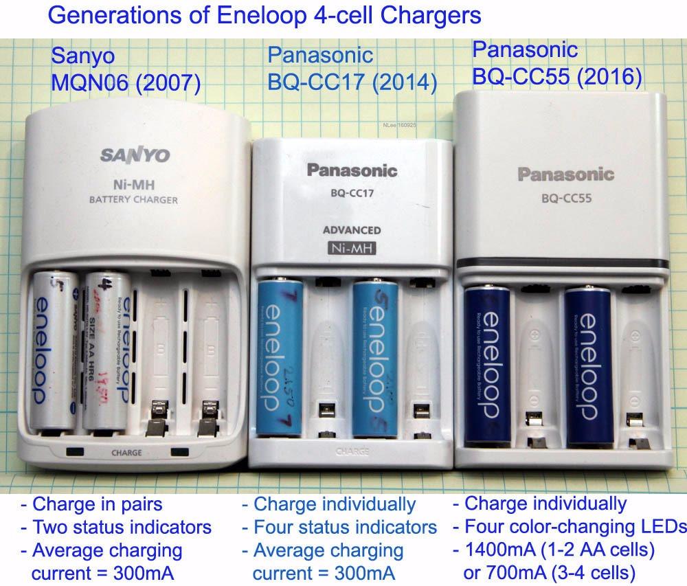

I just use NiMH rechargeables for applications like this. Low self-discharge batteries like the Panasonic Eneloop batteries last months.
Reactions: ght56
I agree with @chrfr. I only use Panasonic Eneloop batteries for all of my devices. Also note that Amazon's own rechargeable batteries MAY be produced by Panasonic, according to some reviewers (and they are less expensive).
Costco frequently has Eneloop battery sets that are a good starting point.
For quite a few years, NLee's reviews on Amazon were the gold standard for this type of product. See the links below for some examples. The final link is to the AmazonBasics battery, which (at the time) NLee concluded was the same as the Panasonic Eneloop. These reviews are all a few years old, but I would still follow his advice:
