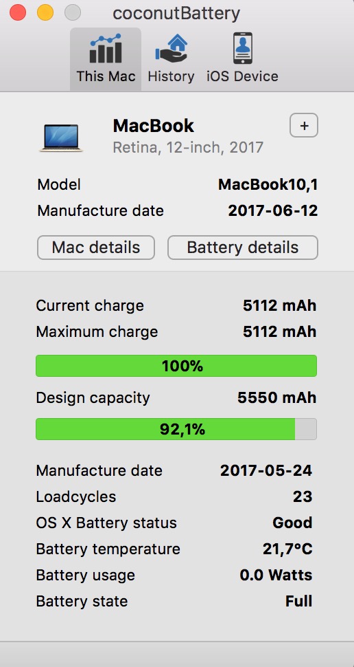

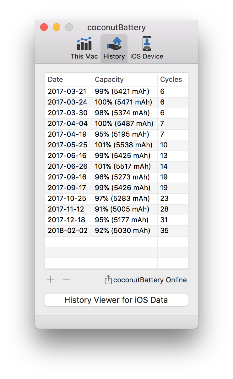

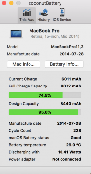

Sorry for reviving this thread, but I am disgusted with the battery of my MacBook 2017.
My 3.5 year old MBP has LESS battery wear than my 6 months old MB.

I guess this answers my question regarding whether rMB batteries have been improved since the 2015 disastrous model.
Mine is more or less always connected, largely because of what I've read about the battery behaviour – I prefer to have it plugged most of the time, so that when I need to use it on battery I have 90% instead of 77%. I know it's not recommended, but based on what I see on this forum there seems to be no way to use the rMB that will not cause the battery to degrade at terrifying speed.

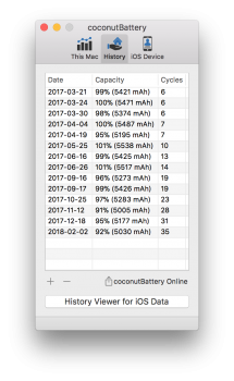

The battery capacity readings seem to fluctuate a lot, as you can see in navaira's screenshot.
I think 93% after 1.6 years are okay, but my 92% after 6 months are rather scary.
If it keeps degrading at this level, I will easily hit 80% within the 2 years of warranty.
