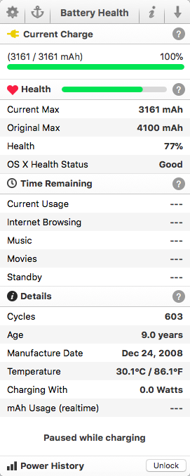

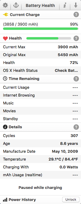

Here's my 2008 MacBook5,1 (aluminum unibody 13"). Not too bad, given the age and number of cycles. My 2009 MacBookPro5,5 hasn't fared quite as well though.
