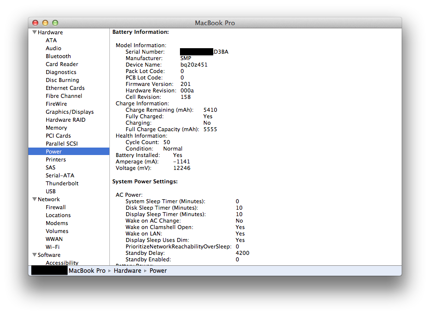

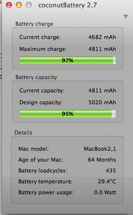

I'm kind of at a loss, honestly. Is this normal? At this rate, 100 charge cycles will take me to 0% battery health.

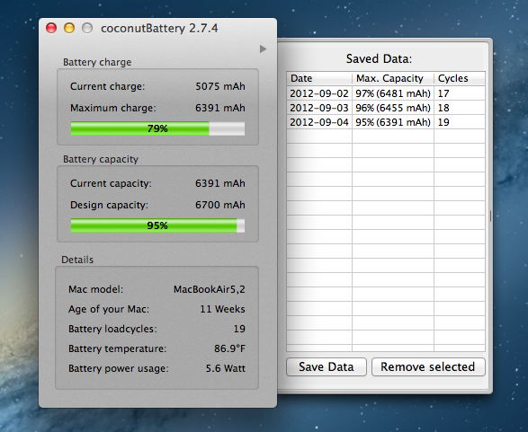

My MBP battery has quite a large fluctuation anywhere from 95% down to 85% and there seems to be no rhyme or reason as to when it goes up or down. I always use it the same with mostly connected to power, yet some weeks it will hover around 85% and others will be 95%
Doesnt ever seem to dip below that though. Also my battery has 236 cycles.
Battery can fluctuate - however if it continues this trend over a few more days then you may have something weird.
Yes it is normal. It is normal for the health of the battery to increase and decrease with every charge cycle.
My GF's MBPs battery health was down to 69% last week. After cycling the battery a few cycles its back to 89%.
Unless the health stays below 80% before a 1000 charges it is normal.
The capacity does not start at 100% and just decrease to 0 - it can fluctuate up and down. You don't have anything to worry about at this point.
Thanks for the info, everyone. Does everyone think this battery capacity is normal for so few cycles?
I would try the battery recalibration method. I did this on mine - a new 15" MacBook Pro (2012) and it increased to full charge capacity to about 71xx from 69xx. Still reads 71xx.
Do you mean let the battery completely discharge and wait till it charges 100%?
It happens to my Macbook Pro too since I installed Mountain Lion. It may be a bug related to the lower battery life reported.

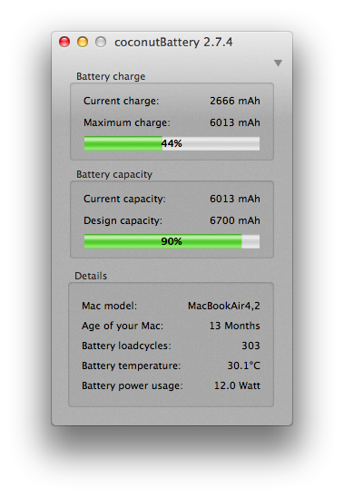

It is normal for a new battery to fluctuate. My 2011 model settled between 88 and 92% and has been there for over a year.
There is no need to calibrate the batteries in the current MacBook models. Just use it and don't worry about it.
mines dropped to 90% from 95 when i bought it. very annoying every time i check its dropped again
Why do you check the battery like this? Seriously - it's not worth the time and effort. There will be an occasional bad battery out there that doesn't last as long as it should, but all you need to do is head into an Apple store and have them check the battery just before your Warranty expires (1 year or 3 years with AppleCare) - if there is a problem, they will replace it. In the meantime, you do not need to check your battery level or worry about it.
It is perfectly normal if your battery health (maximum capacity) is more or less than 100%, even when brand new, or if it fluctuates up or down over time. For further details, read the CHECKING STATUS AND HEALTH section of the following link.

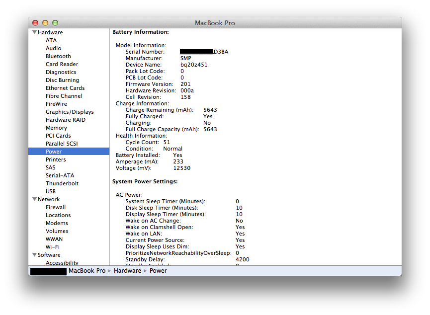

Draining the battery and charging as stated above increased the Full Charge Capacity from 5555mAh to 5643mAh.
This should increase the accuracy of your battery meter and give you slightly more runtime before the machine forces hibernation.
Worth a shot.
