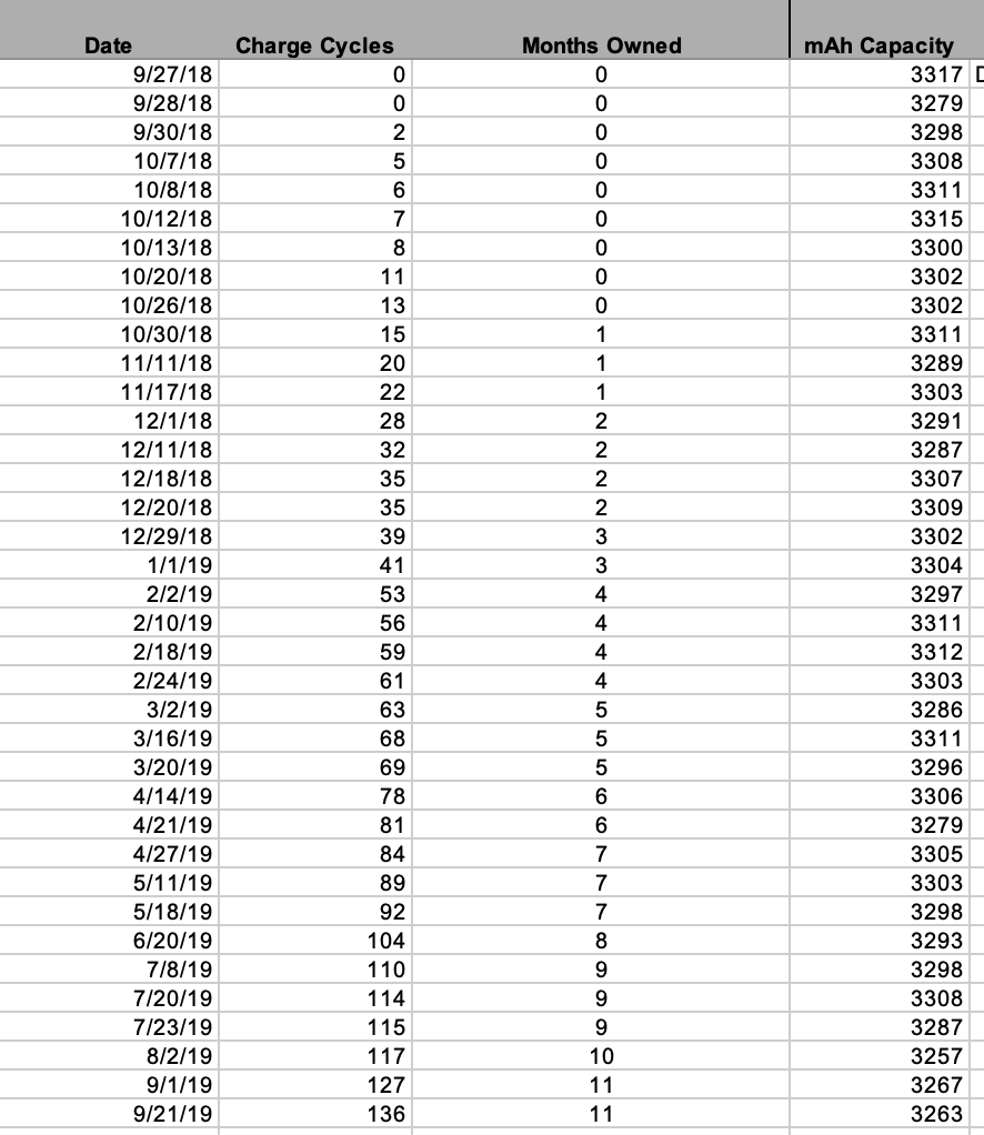

I guess you're right. It is basically linear, lol. Capacity basically stayed the same in the year I owned my Xs MAX. Well, now I guess I gotta stop saying that. hah.

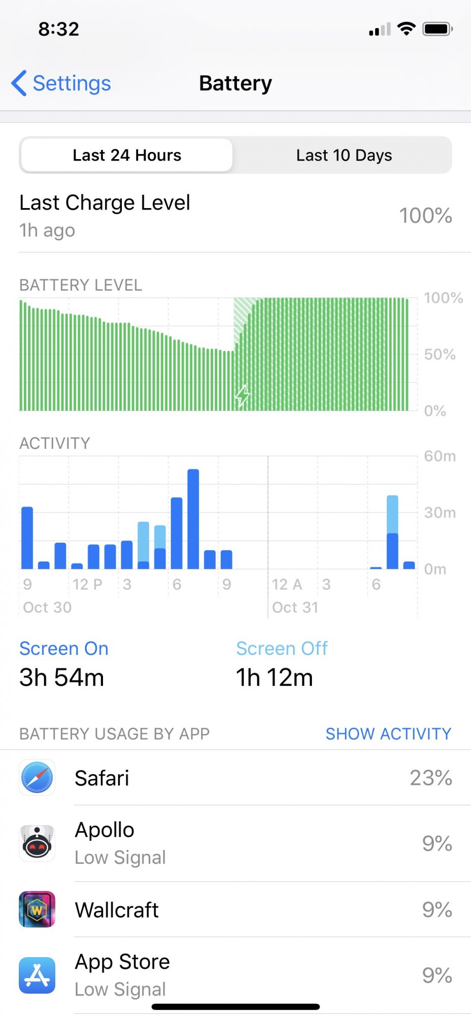

Last night:
It just needs to learn your schedule probably. Updates and restarts and odd schedules can disrupt its learning. Apple would rather have it fail and charge to 100% then fail and you go out for work with 80%.
My schedule is all over the place but you can see it does work but its figures you out.

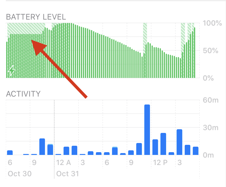

My hours are random some days I leave at 4 some days I leave at 6. Just depends on how I feel. I was actually quite surprised it worked at all for me.
I did notice it did work a couple days after I went out at 2am to pick up a friend.
