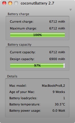

I'm a noob macbook pro user who bought it yesterday. As soon as I get this macbook, I did some tests to see if it's okay or not. When I tried to check my battery status with coconutbattery, it says that my battery's capacity is 97% even though it was first cycle on the first day. (It also says that it's 9 weeks old). I bought this macbook from Amazon and this battery thing kinda bothers me even though it's not going to affect my usage a lot. So, do you think this can be considered as defective item from Amazon or just normal macbook pro?

Well if it's under warranty go into the Apple store and talk to someone about getting a new battery.
If you request it they will most likely replace it for you because it is covered under warranty.
Just make sure that you tell them about the battery being 9 weeks old.
Before you do that though, run it through a complete cycle. Completely drain the battery and leave it off during a full battery recharge and try again.
If no avail go to the Apple store.

It is 100% completely normal for the FCC to fluctuate ±5%. It's not defective. Welcome to batteries!!!!!
Also, coconutbattery measures age based on the serial number. The serial number can be decoded to show when the machine was built. Your machine could have easily sat on the shelf in a warehouse for 9 weeks.
