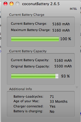

I have an old MBP (2.16 GHZ); 2 Gigs of Ram and 120 Gig hard-drive. I have used my battery a handful of times since I got it, and now when I try to run off of battery power, it says it is fully charged, but after unplugging it, it dies about 3-5 minutes later. I remove the battery after the shut down happens, press to button on the bottom and all five green lights are lit indicating it is full.
Any suggestions on what to do? I really can't afford a new battery... And it doesn't seem like it is the battery anyway.

Here you go.

oh i missed that
try to reset both NVRAM and SMC
then calibrate the battery: empty it, wait for 5 hours then plug power cord to recharge
then use it a little bit and see if the problem is solved or remains
if it's still there, have your computer tested by a CMAA

Problem is I can't charge it all way down, because it shuts off at around 93%...
