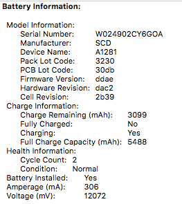

I am including a screenshot of the battery info in the system report.
Has anyone got an idea of how to solve this as it does not seem to be a fault with the battery that I can see.

Have you looked at the jpeg I added to see if everything there looks correct?
Do you know from your tech knowledge if all the settings are correct.

First I would like to see if the problem is the battery so I am hoping someone here or yourself have any other tests I can do to find out if the problem is the battery and as I said I thought if the battery was faulty something would show up on my battery info jpeg
