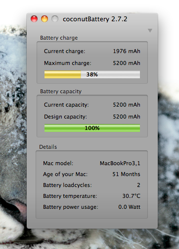

I have Macbook Pro with Snow Leopard OS, and I have some problems with battery charging: it won't charge above 35-38%. Here is coconut battery screenshot:
It charges normal untill 38%, and then it says "battery is not charging", and led on the magsafe is green. Battery has only 2 cycles.

And I tried to use it on battery until computer turns off last night, and it was in that state (fully empty) during the night, and today I plugged it to magsafe, it has been charging until 33% (1766 mAh) and it stopped charging again. And I can not leave it fully charged because it stops charging on 35% (1766 mAh out of 5200)

Based on the OP's screen, I'm going to say the battery is ruined. I mean, 2 cycles in 51 months!!
Unless the OP just bought a replacement battery for their 51-month old MBP. Remember, that's the age of the Mac, not the battery. If, indeed, the battery is original with only 2 cycles, it's toast.
Ah, he didn't mention it was new until the 3rd post. 😱

If you've verified the MagSafe is not faulty and securely connected, and if you've verified the battery is securely connected, and if you've reset the SMC properly, the only thing left to do is take it to Apple. You may have a defective battery. You didn't, by any chance, buy a non-Apple battery, did you? That would explain the problem.
Unfortunately I bought it on eBay, and there is no any official apple dealership where I live (Bosnia and Herzegovina).
Then it's doubtful it's an Apple battery. You could try to see if you can return it, then buy a real Apple battery from Apple or Amazon.
hmm, I bought it from the US, and it was 99 USD + 34 USD shipping. There were a lot of batteries for about 35 USD with free shipping from China or Hong Kong, but I bought that one with MacBook pro 15'' oem battery label.
It might be legit, but there are way too many cases of "knockoff" batteries being sold on eBay, which have many reported problems. Try returning it for a replacement or refund. If you can get a refund, then go to Apple to buy a replacement, so you're certain that what you're getting is legit, and backed by Apple's reputation. That's my best recommendation.
