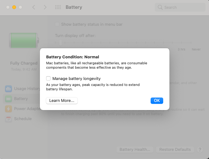

The other setting under Battery Heath>Manage battery longevity, actually lowers the maximum battery capacity reported by the MacOS, which causes utilities such as iStat Menus to report (prematurely) low battery health percentages. This has resulted in numerous threads complaining about poor battery life. Turning off Manage battery longevity will restore the actual max capacity reported by the OS, after a few days.

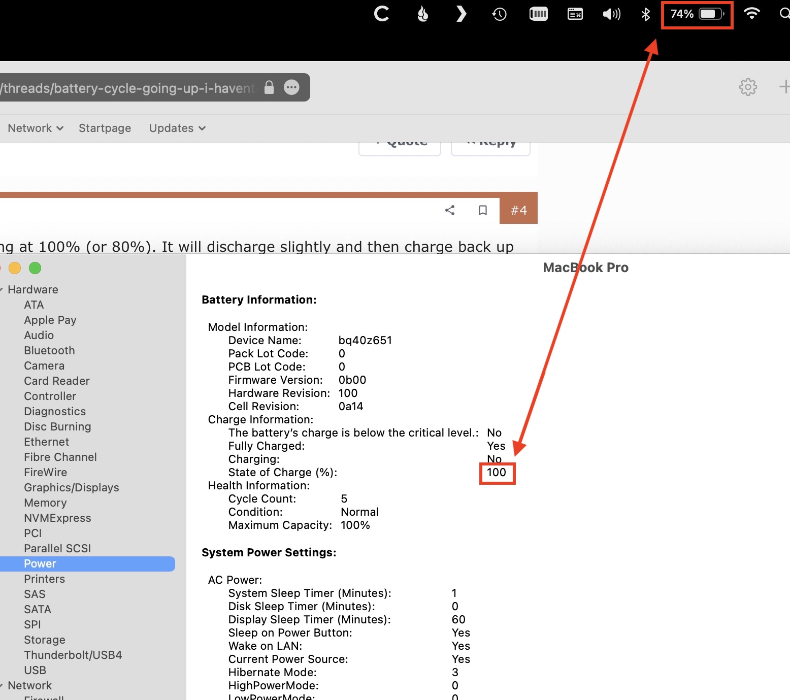

Agreed, however this is not normal behaviour... Monterey bug perhaps?

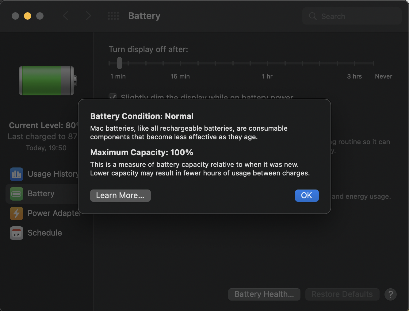

Manage battery longevity? I have no settings under Battery Health
Same here on my brand new 16' MacBook Pro. No such setting called manage battery longevity. I'm checking threads to find out how to charge correctly. Are there actual steps? The laptop has been plugged in (closed when not using it) on a desk where I use it since I bought it a few weeks ago. Woke it up today and it was showing 78% charge with the orange light showing even though it was plugged in. This is confusing.
Must be an Intel vs Apple Silicon thing. I have the 2020 13" MBP i7 (need to use Windows 10 VM for certain work stuff). The battery health support articles on apple.com read a bit different for the Intel and AS notebooks- most notably the absence of the section on controlling the battery health management features in AS article.

With battery optimization the battery will sometimes stop charging at about 80%. When the OS thinks you might need battery power, it will charge to 100%. Li Ion batteries don't like to be kept at 100% for long periods of time so Mac OS will sometimes go on battery power for a period time and then bring it back to 100% later. So it's sort of a yoyo effect between 80 and 100%. Do that 5 times and Mac OS will consider that 1 charge cycle. This will probably happen more often shortly after getting the MacBook as Mac OS is trying to figure out your schedule to anticipate the charge to 100%.
