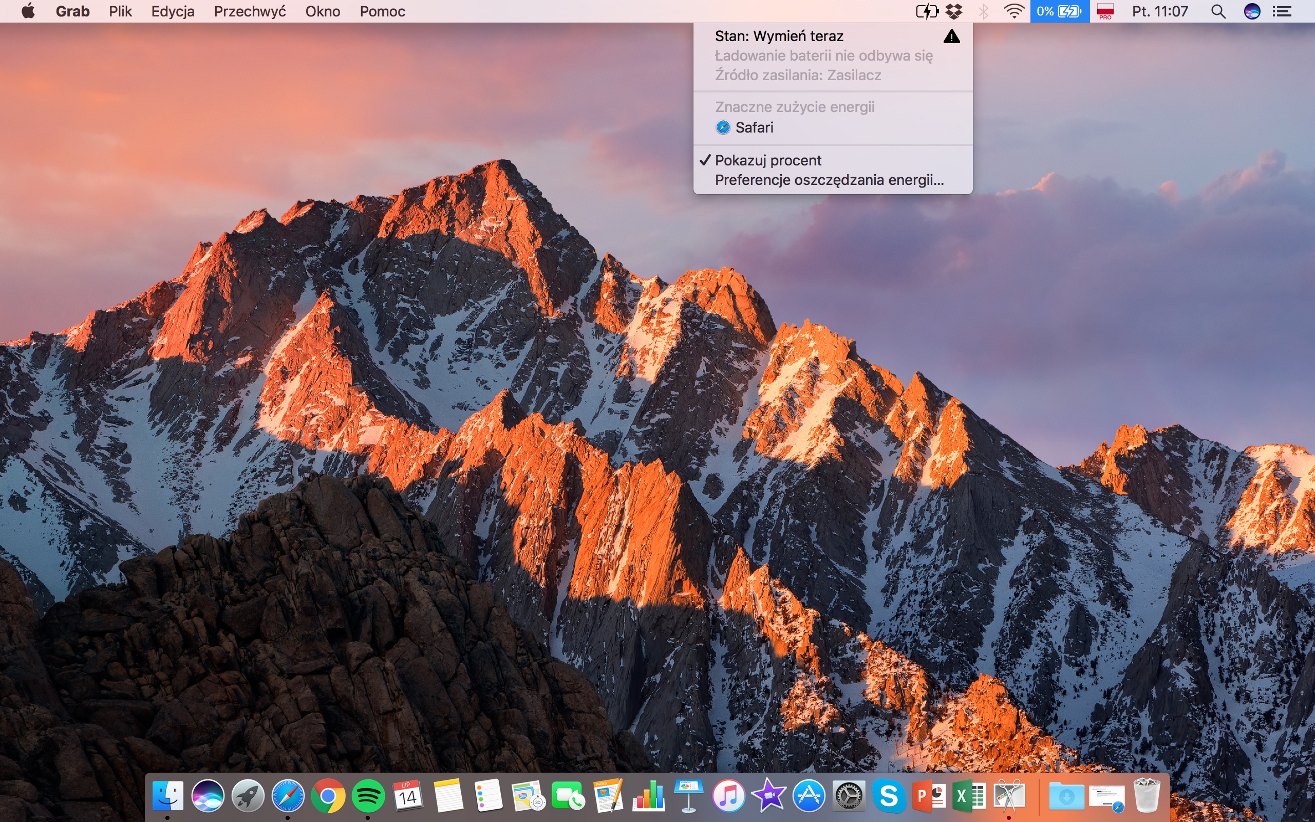

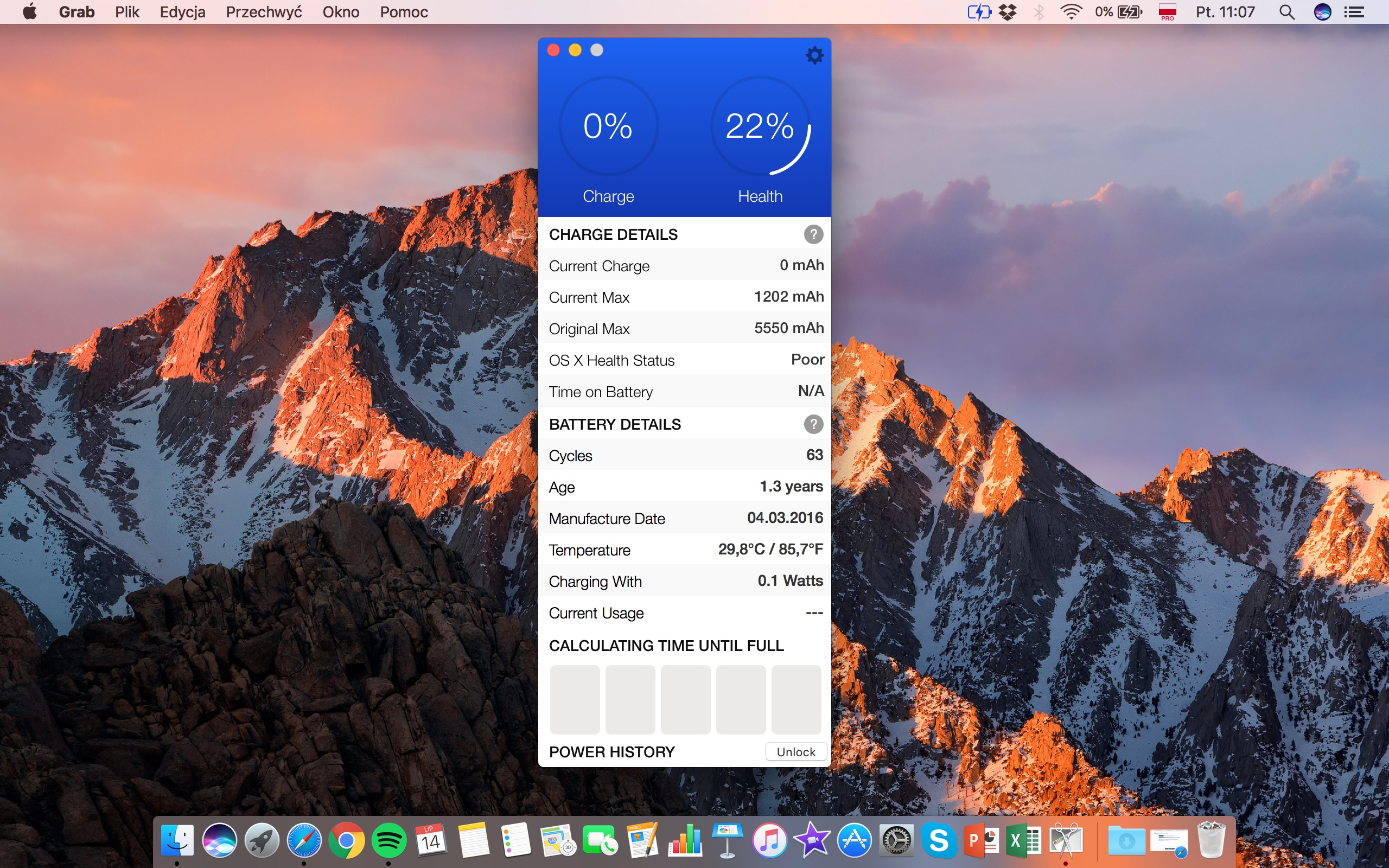

So something weird happened to my macbook. It didn't charge at 58% then it dropped fast while I was watching netflix and then didn't run without plugged in power. Now it's on 0% and still can't charge.
Fun fact; my one year guarantee expired 2 weeks ago -.-
In system it says replace now battery.
Here are some screens

Still take it in, Apple have been known to honour warranty if its just a short while. Depending what country you're in you can have upto 7 years warranty against defects that cause failure (not natural wear and tare). A battery should last more than a year and 63 cycles.
You never know till you try.

I'll try and call an authorized service because in Poland we don't have apple stores.
Mine is at 84% at 212 cycles, that still seems pretty bad considering I do my best to look after it. I have apple care though so when it drops below 80% I'll bring it in for a battery replacement. I'd definitely recommend you bring yours in anyway.
Just as an aside, 63 cycles in a year seems very low. Do you often keep the charging cable attached even when the battery is full?
No I don't. I use it only while I'm travelling so when I need it I just unplug it.
