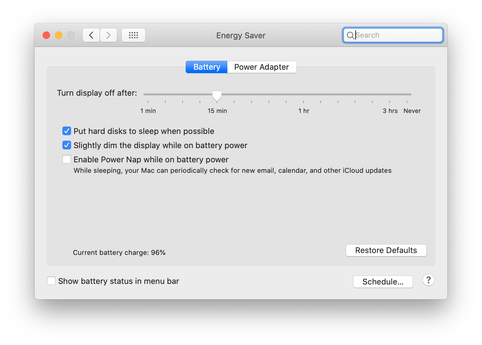

show me energy settings - have you enabled the "Put hard disks to sleep when possible"?
I’ve been noticing that my 2020 i5/8GB will go to sleep with say 75% battery left and in a few days I will open the lid and it will be completely dead at 0%. How can I find out what is draining the battery while it is sleeping?
Is Power Nap while on battery on? Even so, it shouldn't drain your MacBook that much. Makes me think the MacBook isn't really going to sleep when the lid is closed, and only the display turns off. Something is preventing the MacBook from going to sleep. Check Console logs if the MacBook really goes to sleep or not.
This is the way it was without any modification...

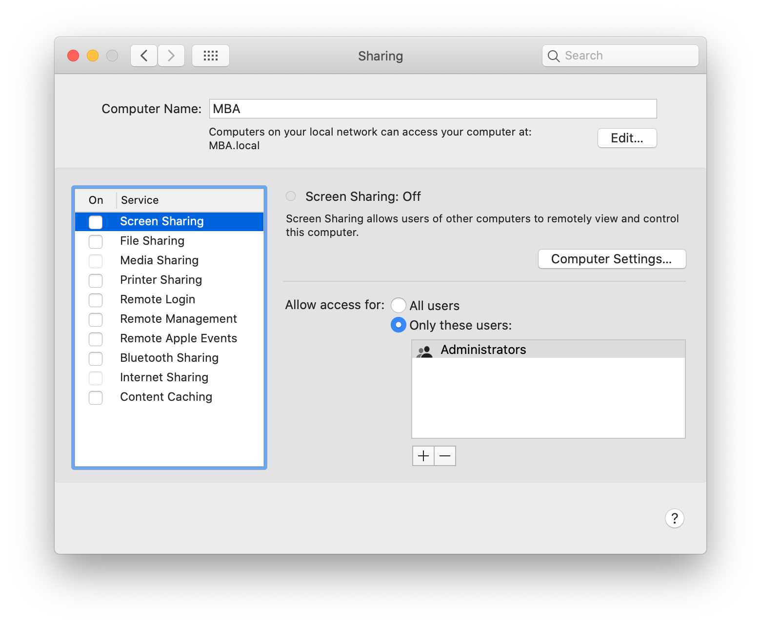

Regarding not going to sleep, I ran pmset -g and see the following:
System-wide power settings:
Currently in use:
standbydelaylow 10800
standby 1
halfdim 1
hibernatefile /var/vm/sleepimage
proximitywake 0
powernap 0
gpuswitch 2
disksleep 10
standbydelayhigh 86400
sleep 15 (sleep prevented by sharingd)
hibernatemode 3
ttyskeepawake 1
displaysleep 15
tcpkeepalive 1
highstandbythreshold 50
acwake 0
lidwake 1
But when I check the Sharing preferences pane, I see this:
Wonder what gives?
