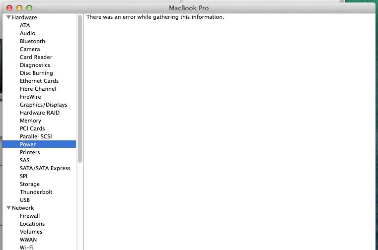

Hey guys,
I have a MacBook Pro 13" (Late 2011).
I installed some new RAM today and now my MacBook has an "x" over the battery icons and reads "Battery Not Available". I tried a restarting, a PRAM reset, and SMC reset. None of it worked.
I used iFixit's instructions and they have you disconnect the battery-logic board connector during the RAM install. I have made sure, SEVERAL times, that the connect is properly secured. Is it possible that I shorted the battery or something during this process? Anyone know of any fixes? Please don't tell me I have to spend monies on a battery change. 🙁
This is what shows up when I try check the battery status:

How did you disconnect the battery? Did you use a metal or a plastic tool? A metal tool can easily short the connector, damaging either the battery or the logic board.
You said you have checked that the connector is seated properly, but have you tried disconnecting and reconnecting it?
Crap I used a metal tool. 🙁🙁🙁
I have reconnected the the connecter several times. No dice. Wouldn't the computer show other symptoms if the logic board was damaged? Should I try replacing the connecter?

Most likely it's the control circuit on the battery that was damaged, but without a multimeter or another battery to try, it's hard to be absolutely sure. The SMC could have been damaged too, but don't lose your hope just yet.
You can try running Apple Hardware Test, see if it gives you any errors. Try running it both with the battery disconnected and connected.
If you get any error messages, post them here, and we'll try to figure them out.

I ran a Hardware Test before and nothing came up. I'll try it with the battery disconnected-- sounds like a good idea, I'll let you know. 🙂

This actually sounds quite promising! If the SMC was damaged, you should have seen an error in AHT. So it sounds more like a battery issue. There is still a slight chance that some passive components on the logic board could be toasted, but the battery controller/safety circuit would be more likely to go.
You could also try leaving the battery disconnected overnight. I don't know specifically what kind of protection the MBP batteries have, but it might actually be a tripped safety circuit either on the battery or on the logic board, that could come alive if you leave it disconnected for a few hours and reset the SMC.
Anyway, disconnect the battery, run AHT, and see what comes up.

Tried an ATH with battery connected. No problems found.
Tried an ATH with batter not connected. No problems found.
Left battery disconnected overnight. Didn't work. 🙁
When I do an SMC reset, none of my power settings get reset. Could this mean the SMC is simply not resetting?

I took it the the Genius Bar.
They figured it was a battery issue but a battery replacement didn't fix it.
Got the logic board replaced and now everything is working fine. Oh, and they also removed my third party RAM because it was apparently causing kernel panics. Yay for a $300 fix and now 16GB of useless RAM.
