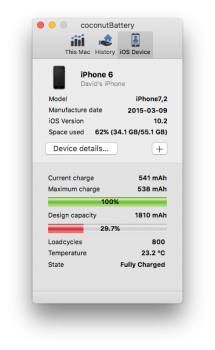

I made a thread a while back when my batter was at 82%. Now it's at 29%. Does this sound like it would get covered by AppleCare+?
I could give them a call but driving to the store is about 3 hours away. That's a bit of a drive to be told too bad. Is the information from CoconutBattery the same Apple would see?

Apple will use their own diagnostic software to determine if your battery is failing. And since their diagnostic software is proprietary, I have no idea if it looks or acts like CoconutBattery. However, it does appear from your screen shot of CoconutBattery that your battery should be replaced. Apple charges a flat rate of $79.00 to replace the battery. You could do it yourself for less and save the 3 hour drive.

I called up Apple and let them know what was going on (I just read this thread so I didn't know about the app). They had me start a diagnostic thing with them and they asked me a bunch of questions. They didn't tell me I was below 80% outright but said I had over 800 cycles. I told them I had used CoocnutBattery and saw I had 29%, and said you've probably never heard of that app. She said absolutely never heard of it... thought that was funny.
In the end they authorized a replacement. They said they could send me the replacement but would need to put a hold on my card or I could go to the Apple Store. I chose the Apple Store, a friend asked me to take her mom's iPad too (something with the power button or whatever).

Just an update. I took it to Apple on Friday and they replaced it under AppleCare+. I saw the screen when they did the diagnostic and it was right above the red, but still in the green. When I called AppleCare they said they put in my notes to replace the battery.
