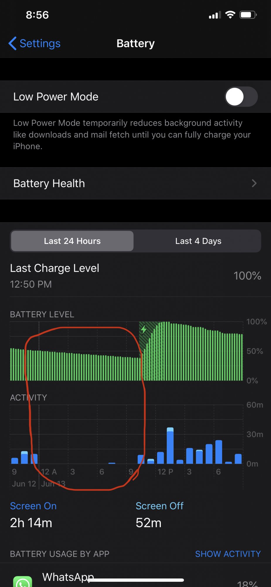

I recently noticed that my iPhone X suffers from severe battery drain issues (details here). In short: I lose 40-50% overnight.
I then decided to check the battery life on my 10.5 iPad Pro. Normally I always turn it off during the night but I left it on yesterday to do the battery test. The result: I lost 24% in 14 hours. That’s why I decided to create this new thread.

Try to disable iCloud for a while, to know whether it’s the culprit. Another thing is try to reset all setting. I also experienced higher (not much) battery drain in 13.5.1 but it seems it’s back to normal after few days.
Thanks for the suggestion. I now logged out of iCloud on my iPad Pro and cleared all apps out of the app switcher. It's at 67% now. I'm coming back to it in 12 hours and see how it did. I will post an update then. If that helped I'm going to log back in and see how it does then.
If the battery drain is solved then, I'm going to try the same with my iPhone X.

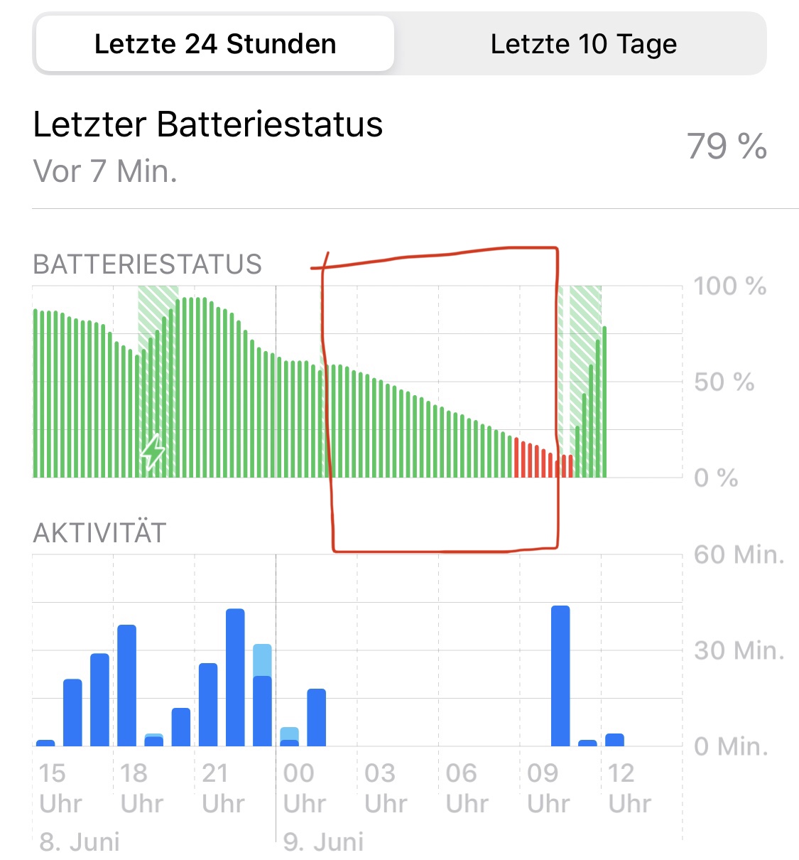

Strange. When I go into the battery settings and check the night time slots when it drained the battery there’s not a single app listed and the screen on time is 0. It just looks like this:
I also experience a huge battery drain on my Xs max after updating to iOS 13.5.1 .. I did a clean install using iTunes and i’m still having a huge battery drain during standby about 10% of drain from 12 am to 10 am (around 9-10 hours).

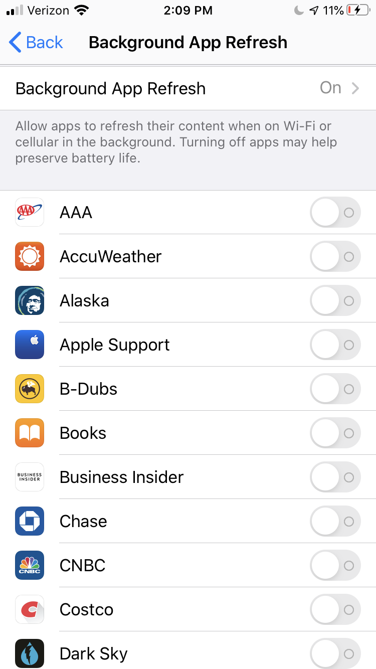

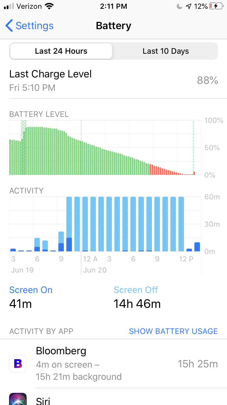

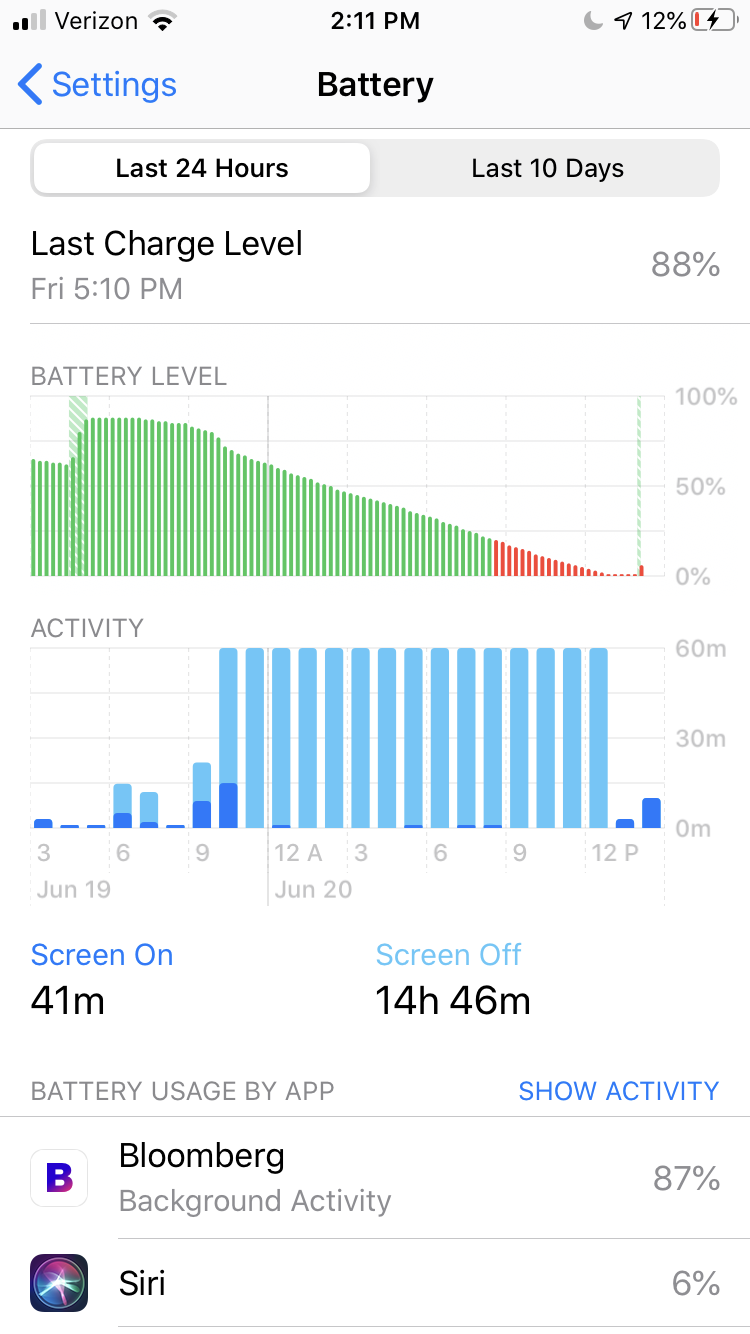

There's obviously a major bug. I found a Smoking Gun. iOS is clearly very very confused.
I have an app named Bloomberg. I only use the free features, I don't have a subscription. This app just killed my phone overnight.
But, it doesn't even appear in the list of apps for Background App Refresh!!!
Here are three screenshots which show the app missing from the refresh screen and also show how the app killed my phone overnight. The last two photos are almost the same, the difference is percent vs hours and minutes.

Background app refresh is just one aspect of background functionality offered by iOS. Apps can still perform actions in the background unrelated to it. That said, those abilities should be limited to shorter periods of time aside from a few scenarios where location services or media playback is involved and can be used for longer background usage. If an app is never launched or is closed after use then it shouldn't be able to use background services, otherwise it can make use of them.
Some apps do random things in the background such as battery draining and data consumption. If you do a forced close of all those apps, there's a big chance the battery & data consumption is over.
