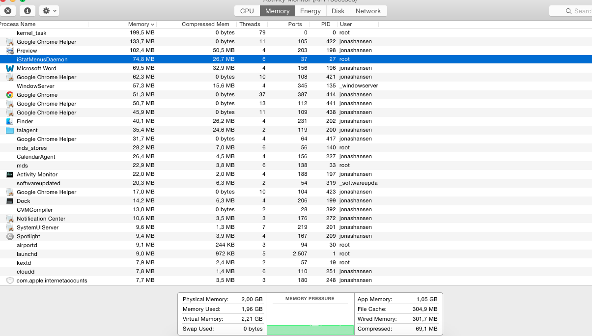

No the old drive was actually also running yosemite.
You can check out my activity monitor in the file attached. There is no yellow, or red.
Also I checked my battery, it says normal..

Okay now it changed..

Newegg lists the Crucial MX100 128GB to use 0.1 (idle) to 0.15 (active) watts. That should be lower than your spinning drive.
Something else must be going on with your system. It is probably indexing lie others have said.
