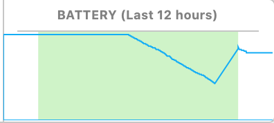

Hi guys,
I just encountered a strange battery drain issue on my 2017 13" MacBook Pro. Here's the story:
  • I used and charged the MacBook to 100%
  • I unplugged it and closed the lid
  • I came back to it a few hours later and then the battery was at 88%
I used iStat Menus to check the battery graph. Here's how it looks:
The circled part (+ the empty part after that) is the time the MacBook was sleeping. Something strange: The red circled part did NOT show up at first. Only about after 1 minute it suddenly showed up.
Anyone has an idea what could have caused this issue and what I could do to prevent it for the future? iStat Menus unfortunately doesn't show what app/process used the energy in the circled area.
Thanks and best wishes
Chris
p. s. I'm running macOS 10.15.6 with the supplemental update.

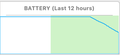

I'm having the exact same problem, also running Catalina v.10.15.6. Here's a screenshot from Activity Monitor. The drop-off is a steady linear decrease regardless of whether the computer is awake or asleep. I tried creating a new user account, logged out of my normal one and into that one, with no effect. I also quit all possible culprit apps, again this didn't make any difference. My laptop is a MacBook Air (Retina, 13-inch, 2020), basically brand-new.
Yesterday it drained the battery completely while sleeping for around 10 hours.
And oddly, after charging to about 80%, the issue disappeared (for now at least). Another thing that I've noticed since this started is that the laptop takes approximately forever to wake from sleep. Not sure if that's related.

Thank you for the reply Honza1 but I don't think that's the issue. The battery drain is constant whether the laptop is asleep or awake, as you can see from my Activity Monitor plot. That decline was probably half during wake times and half during sleep times. The CPU area of the machine is noticeably warm when this is happening. There's some process that's running continuously, wake or sleep, that doesn't seem related to any of the usual suspect apps (Chrome, e.g.).
Then, it magically stopped happening after a charge to 80%.
If it stopped, then you are fine. Some process finally finished its job. Watch for it in the future.
But what I suggested would have told you more. Your system was sleeping, but some process was waking it up. iCloud is famous (sync photos seems to be done at ANY cost), some system processes also. pmset would tell you who is waking it up - but not why, BTW.
And the fact the battery seems dropping during those short sleep times is more of artifact than real readout. It is typical to see going to sleep at X% and waking at X-Y%, where Y is 1-5. Depends on battery, memory and who knows what... Especially during these short sleeps, it can look like loosing battery all the time.
Which is also possible, but then it would likely be battery.

So it happened again to me last night, closed the lid with 81%, came back this morning and down to 33%. Can you offer any help/suggestions with the log below?
In the log you posted nothing stands out as what might be draining the battery. You will need to look at the rest of the log entires between 2020-08-18 22:09:02 and 2020-08-19 07:42:02 to see what other activity was happening while the computer was sleeping with the lid closed.

FWIW, resetting the SMC seems to have fixed it for me. Shut down the laptop, press and hold the power button for 10 s (apple will come on then go off), and restart. Fingers crossed that it remains fixed!

I had the issue again last night. Looking at the log, still nothing stands out. What other logs can I pull and how do I pull them to see what is causing this issue?
My suggestion is to run the command: pmset -g log and look through it to see what was running in the time between when you closed the lid and opened it again. It would not be practical to post that results here.
That's the thing, after the following few lines of in the log file, nothing occurs or seems to be in the log until 8AM when I opened the lid:
