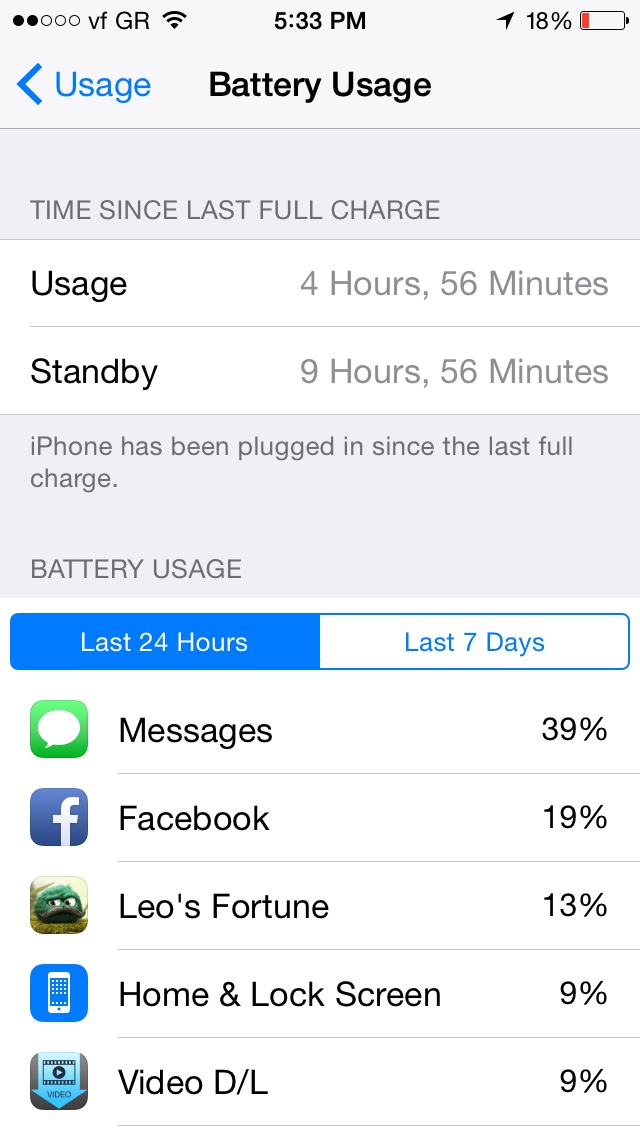

Hi, I have an iPhone 5S running iOS 8.1, but I have very fast battery drain. I have background apps turned off, most of notifications completely turned off, spotlight suggestions turned off, handoff turned and suggested apps turned off and frequent locations turned off! But my iPhone lasts only 3-4 hours of simple use like Facebook, listening my music library or chatting on iMessage. Here is my screenshot of battery usage, it says only 5 hours used (and the iPhone has plugged in since the last full charge) and my battery is 16%!!! Is it normal?? I have give it on apple service and they replace my device two times but the problem is still there. I have do many times restore and setup as new without restore from backup. ImageUploadedByTapatalk1415288633.510930.jpg

Hi, I have an iPhone 5S running iOS 8.1, but I have very fast battery drain. I have background apps turned off, most of notifications completely turned off, spotlight suggestions turned off, handoff turned and suggested apps turned off and frequent locations turned off! But my iPhone lasts only 3-4 hours of simple use like Facebook, listening my music library or chatting on iMessage. Here is my screenshot of battery usage, it says only 5 hours used (and the iPhone has plugged in since the last full charge) and my battery is 16%!!! Is it normal?? I have give it on apple service and they replace my device two times but the problem is still there. I have do many times restore and setup as new without restore from backup. View attachment 511943
5 hours of usage with 18% remaining doesn't seem all that strange/bad. It's not great, but on average it doesn't seem bad either. A lot of it depends on your signal too and the places you go.

If you see, my iPhone was plugged in since the last full charge. So if I did not replugged in my iPhone, the battery with the same usage lasts 3-4 hours!
In that case that screenshot doesn't say much really. Have you tried restarting the phone and making sure no apps are tuning in the background?

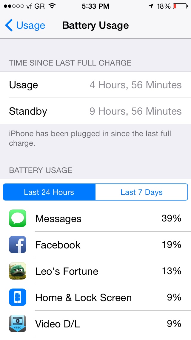

Sounds like there's something else going on as multiple phones with brand new restores wouldn't just have an issue like that... Just too unlikely.
Yes, I have no other apps running and I have done restart and hard reset many times.
