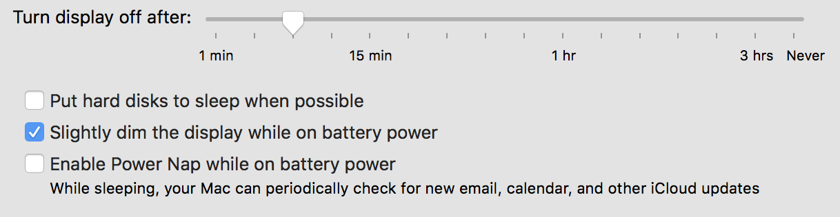

My 2016 MBP nTB has started to loose more battery while sleeping recently, I think.
After 9 hours, the battery went from 71% to 59%. Is this normal?
My energy saver settings are as attached. I also had a few programs open; Safari and Word.
Thanks for the help.

Yes that's the quoted figure. I do remember not long ago that my overnight drain used to be about 1%. Perhaps I should try 'put hard disks to sleep whenever possible'; but the hard disk should be sleeping anyway when the lid is closed right?
Do you have any USB devices connected that can power themselves from the computer? I had a USB hub and Audio Interface connected to mine and had even faster drain when I just closed the screen.
