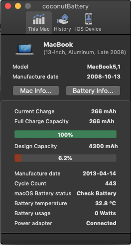

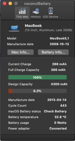

I believe that something is still not quite right with your machine. I have a late 2008 unibody MacBook with a battery that have a very poor health and I am very happy with the performance of High Sierra 10.13.6/Mojave 10.14.6. I have Spotlight turned off if that makes any difference.
Reactions: bmac89
