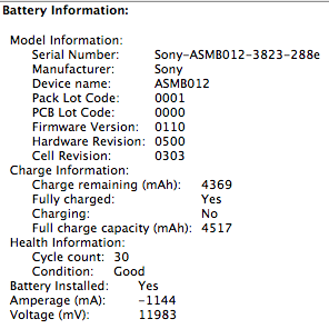

Thanks, but my Mac is just a couple of months old.
I did check though and it said 30 cycles and good condition.
Could the battery be faulty or is this software related?

I went to an Apple shop today and complained about my issues, and the guy had one look at the battery conditions in system profile and just handed over a new battery.
So hopefully that solve my problems
