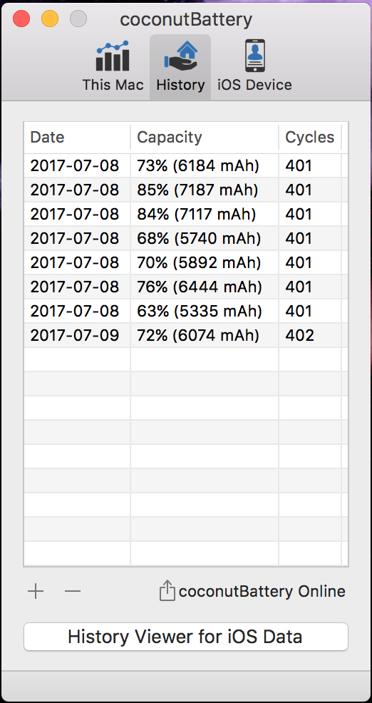

I have a rmbp with a fresh instal of Sierra. The "full charge capacity" keeps fluctuating and I'm not sure what that means. The battery condition is always posted as "normal" in the system information -> power application.
I downloaded the application coconut battery to record instances of the battery, I attached a picture of the condition. These are all within one hour.
Anyone know what this all might mean?

Discharge the battery down to 5%, turn off the laptop and let it rest for few hours.
Fully charge the battery while the laptop is off and let it rest for few hours.
Turn the laptop back on and check the battery.

the laptop is an early 2013 device. and wouldn't a fresh install of macOS be enough to remove any bugs? I'm thinking of wiping it again.
I am not sure why you think this is an OS issue, or frankly much of an issues at all. The numbers are going to bounce around. It is only an estimate. Are you experiencing battery issues?
OS doesn't control the battery in any way. On board circutry is what charges your battery and reports it's status to OS.
Given the age, charge cycles and current capacity; it will flactuate.
As long as it holds charge under normal use, than it's fine.
