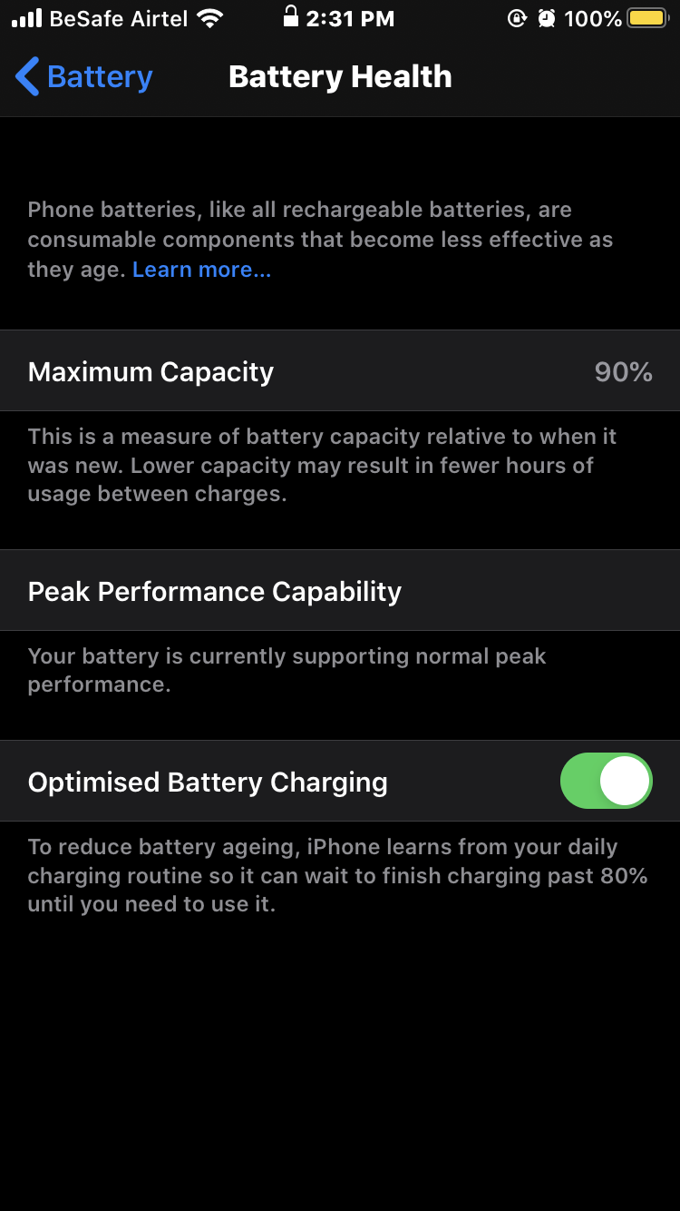

Hello, I bought iPhone 7 yesterday after I fully charged it and i checked the battery health maximum capacity it is showing 90% but peak performance is showing Your battery is currently supporting normal peak performance capacity, is the capacity of the battery good? as you can see from the screenshot below.
Hi, did you get this brand new? It seems odd that you bought a phone at 90% unless it's used. 90% is still okay. Unless you notice performance issues.
