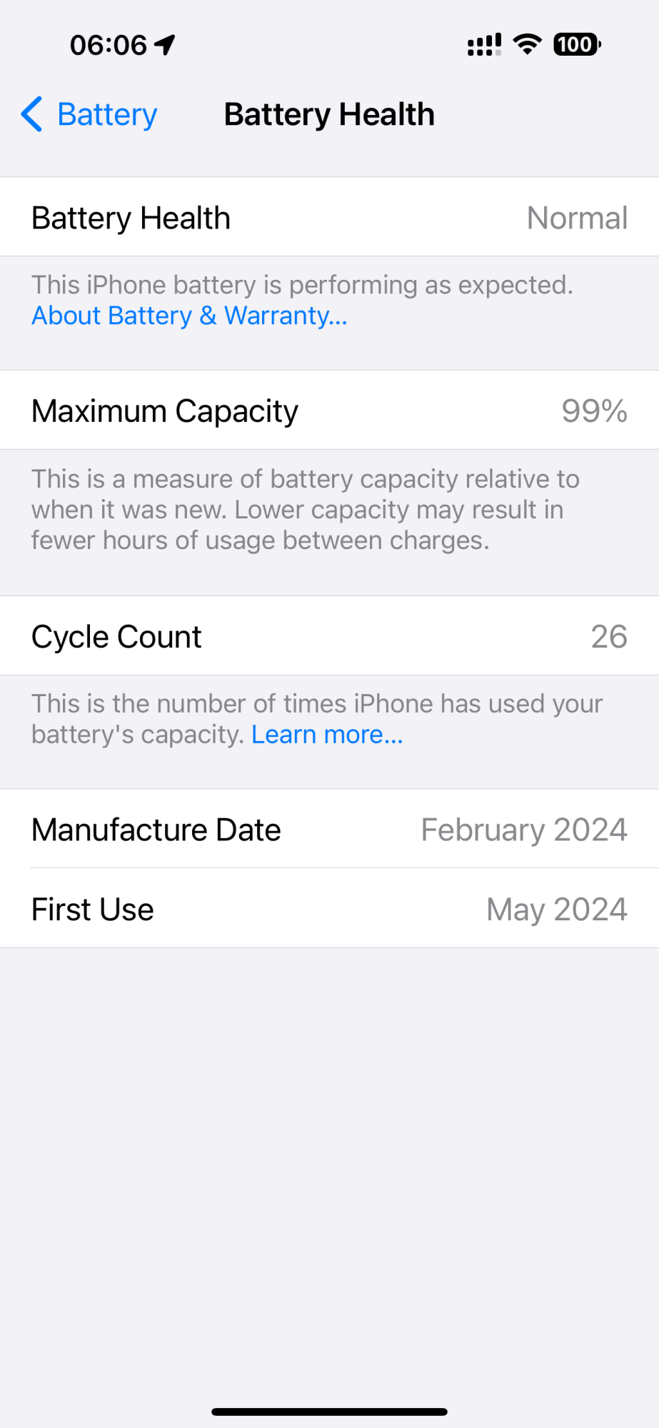

I have my 15 Pro Max since a month and a half and it’s already at 99%.
I got my iPhone 13 new in April 2023 and the battery health in settings has only just dropped to 99%.
Unless you regularly charge your phone to 100% and discharge until it turns off, the capacity reading will be a very rough estimate.
A full charge and discharge damages the battery, so most people shouldn’t be doing it. In short, don’t rely on the capacity estimate.
