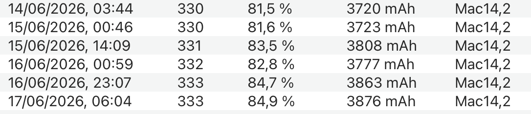

Just thought that is worthy of sharing. I've seen my battery health drop like 8% percent in the past 9 months which I thought was rather much. Decided to stop using AlDente and would you look like that... it went right back up solid mid-way lol.
NOTE: I realize that the actual battery capacity did NOT change. What happened there instead is it re-calibrated itself after seeing the full charge state, or in a sense adjusted the forecasted capacity it calculated to match the real capacity battery accepted the charge for when showing 100%. I was aware that for calibration you do need to occasionally charge it fully and I did just that. But it turns out "occasionally" is still not really enough, not if the OS isn't in sync with the 3rd party app charging limit at least..

I’ve been a long term user of AlDente Pro and it has indeed been fantastic for me. Last I checked my 3 1/2 year old M2 still showed 100% with Apple (hmm) and 97% with AlDente, which for me seems more realistic. Have you ever calibrated the battery with AlDente as per their instructions?
Edit: as soon as my MBP is back from Apple hospital I’ll check on my readings but I’ve never seen this behaviour, if anything else, there were only positives.
Edit 2: ok so not mine, but another thread explaining variations in health. It‘s this one here #4 from @Mike Boreham
