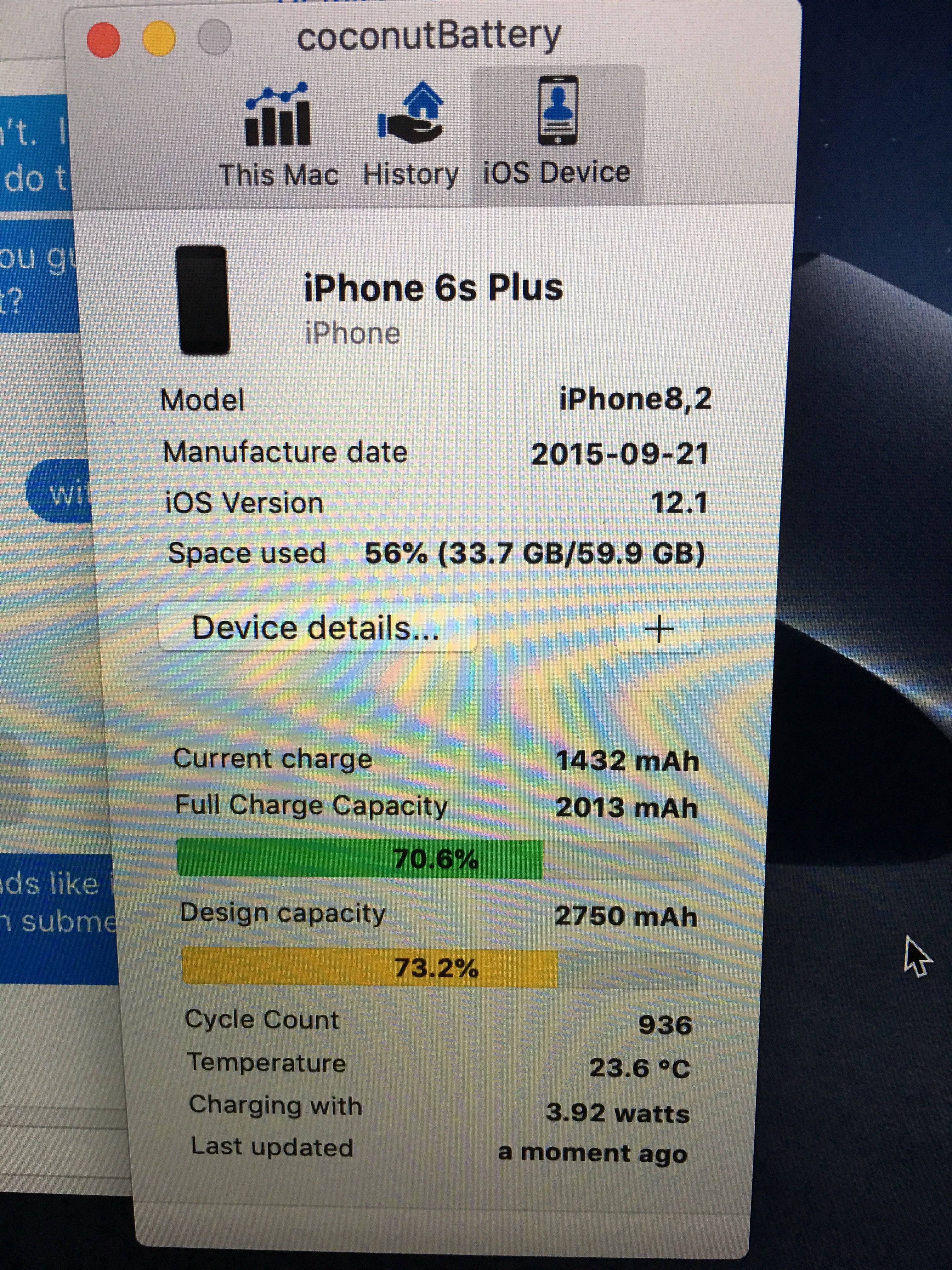

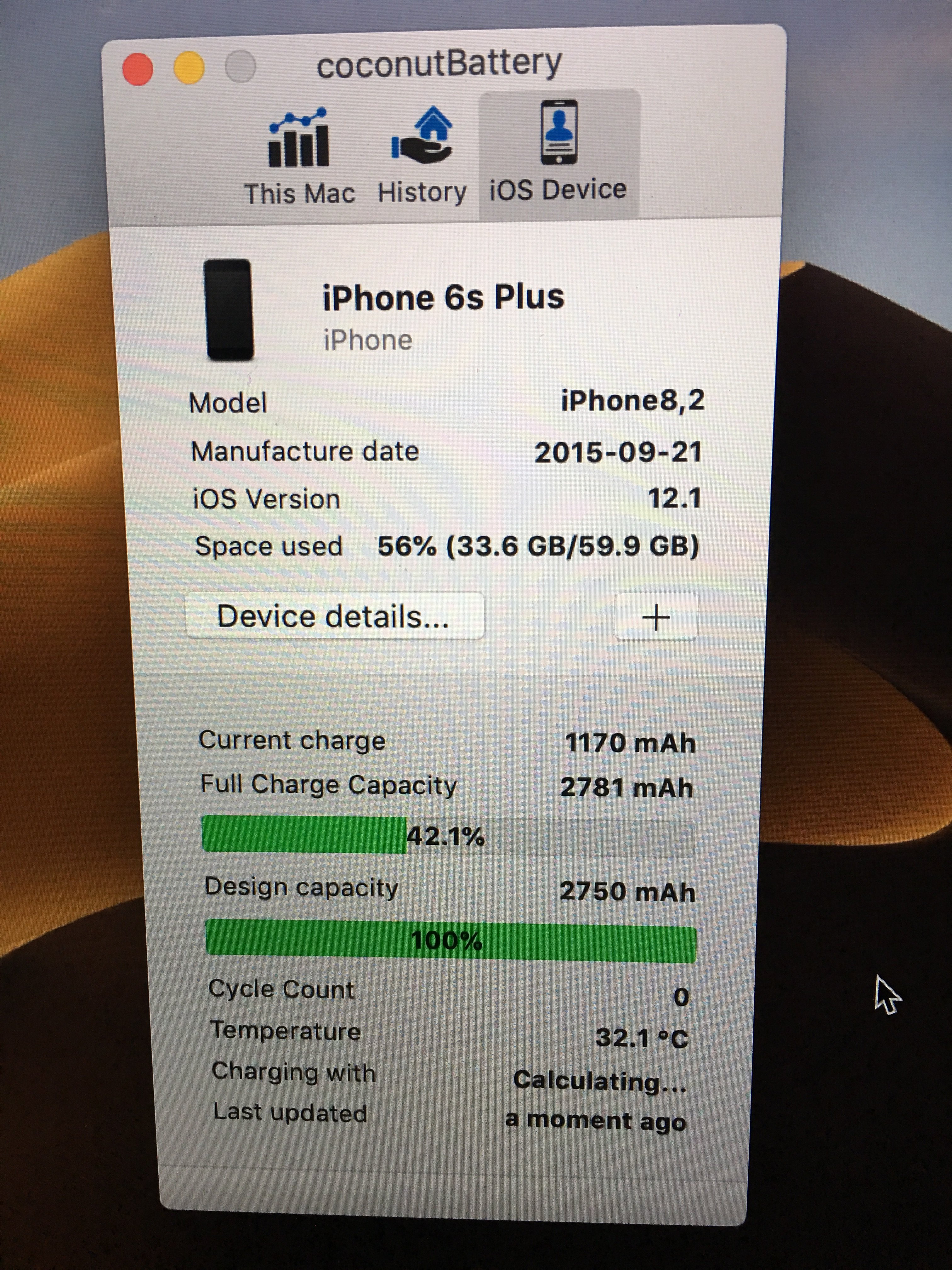

I agree the battery health "app" is horrible it said my 6S Plus was at 90%. I used coconut battery and it reflected it was at 73.2% with 936 cycle count. I ordered a battery kit from iFixit and did the swap myself (yes I know Apple is charging only $29 but I got kit on a cyber Monday deal, am going to upgrade soon anyway and my phone was exposed to water and didn't feel like hassling with the kids that work at my local Apple store). I had fun changing the battery myself, but had I not used coconut battery and relied on Apples built in battery "app", I would've thought it was something else causing the phone to drop from 100% to 50% in 30 minutes of regular use.
