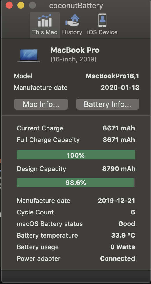

Hey, guess what? I beat all you guys. Check my screenshot.
I have been plugged in since I bought this machine, still it has 6 cycle counts. My charger is 94W.
And I notice my laptop would have 20 minutes 'battery drop time' for about 7% every day after I installed Windows via boot camp (but not running on it).
SO i guess this has something to do with Windows existing in my SSD... don't have a better thought about this.
