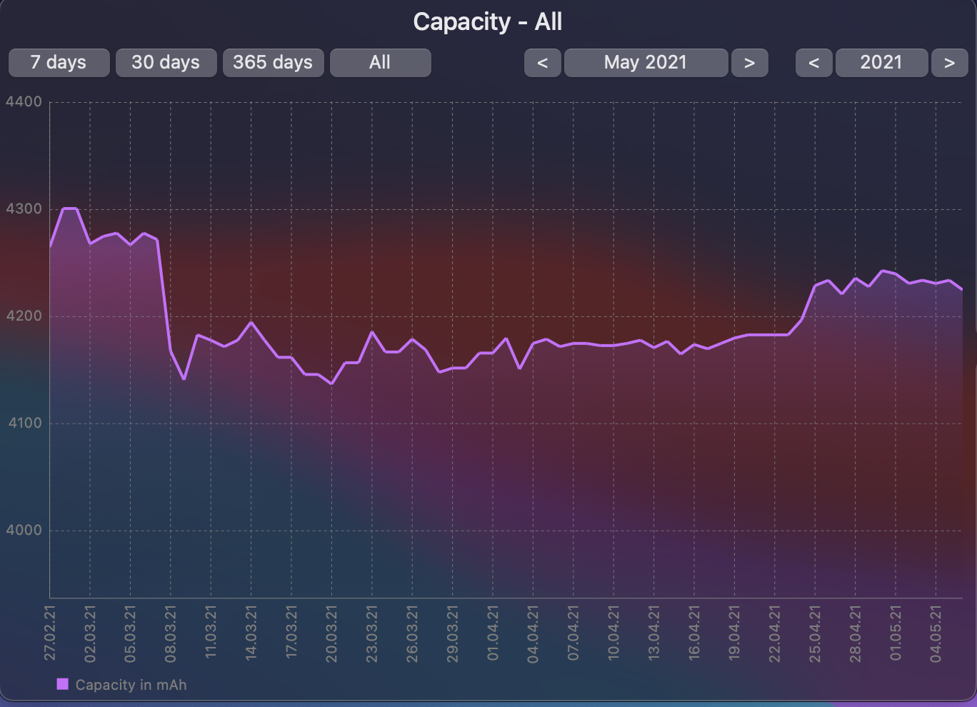

M1 MBA: 30 cycles, 96.2% from ioreg, (using the @jdb8167 script battery.sh from here.)
The health reported by Apple in System Information and Battery Pref pane is still 100%
Note that health is constantly changing. My M1 MBA was new in November 2020 but I only started monitoring it, with Better Battery 2, in late Feb. Since then it has varied from 98.1%, down to 94%, recovered to 97%, currently at 96.2%. I believe this is why Apple only give us a heavily damped number, to stop loads of premature complaints and claims.
It has been plugged in nearly 24/7 with Apple Battery Optimising on but I only saw it reduce charge from 100% once briefly, before I switched to Al Dente in mid Feb.

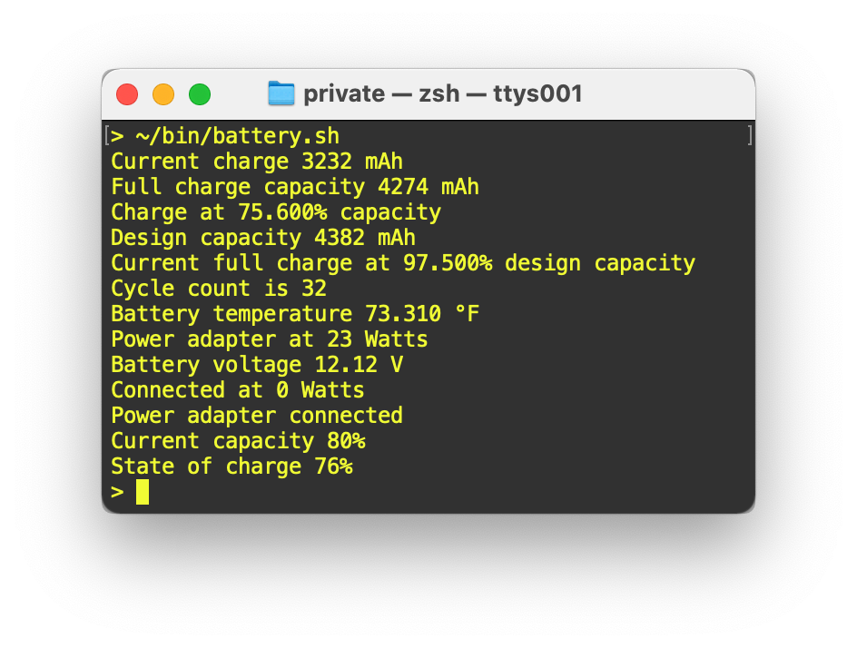

Because I had a little trouble finding it based on previous link; the battery.sh script is here:
You should open a text editor, paste in that code, and save it as "battery.sh"
Then you can run it in terminal like this:
Code:
% sh battery.sh
Current charge 3010 mAh
Full charge capacity 4210 mAh
Charge at 71.400% capacity
Design capacity 4382 mAh
Current full charge at 96.000% design capacity
Cycle count is 49
Battery temperature 88.610 °F
Power adapter at 55 Watts
battery.sh: line 38: bitwise: command not found
battery.sh: line 40: [: -ge: unary operator expected
Battery voltage 12.02 V
(standard_in) 1: parse error
Discharging with
battery.sh: line 57: bitwise: command not found
battery.sh: line 58: [: -ne: unary operator expected
Power adapter disconnected
Current capacity 74%
State of charge 72%

You can install the bitwise command line tool to get rid of the errors.
bitwise-arm64
bitwise-x86_64
This is a slightly modified version from here: https://github.com/mellowcandle/bitwise. I modified it to return values from pipes on the command line based on an output parameter.
