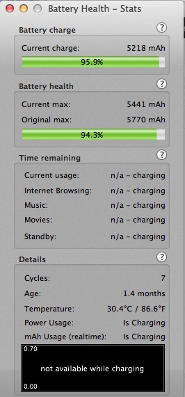

Battery Max dropped from 5770mAH to 5441mAH for only 7 cycles
Hi,
My macbook pro only has 7 cycles for the charging, but the mAH max capacity is dropping significantly from day to day.
The attached is the screenshot i take form Battery Health app.
Is this normal?
