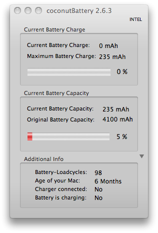

OK here's my problem, my months old MacBook's battery is acting up. I can fully charge it, shut it down, and restart it a couple of hours later. Every once in a while when I do this, my battery seems like it's drained. Here's a pic of my coconut battery screen. It's been at 5% for about 90min. I'm pretty sure the battery its charged but my menu bar and coconut battery say something different. There has been a few times when I've had the computer shut down on me after I thought it was fully charged. Thanks to anyone who can help or is having the same problem.

Look into the System Profiler under Hardware > Power > Battery Information > Charge Information and see what your current Full Charge Capacity is.
If it is the same as in Coconut, or low like it, you should bring it into an Apple Store or authorized Reseller, as you battery has less than 300 cycles (unlike in Farscape) and less than 80% health (capacity).
So you should be able to exchange the battery.

Er... with just a 235 mAh remaining limiting charge capacity of your 'months old' battery... its pretty much obvious that its dead!
Replace it. Nothing else will work unless you plan on crippling your notebook as a permanent desktop!
