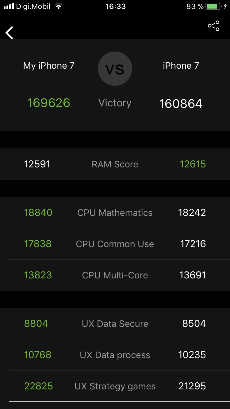

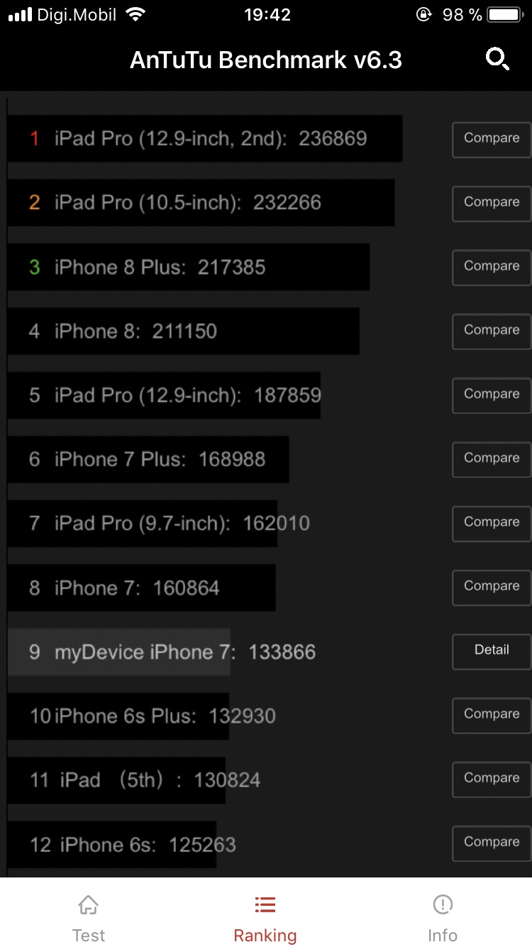

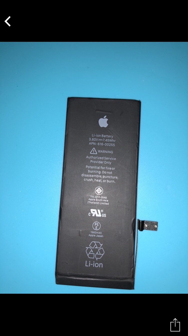

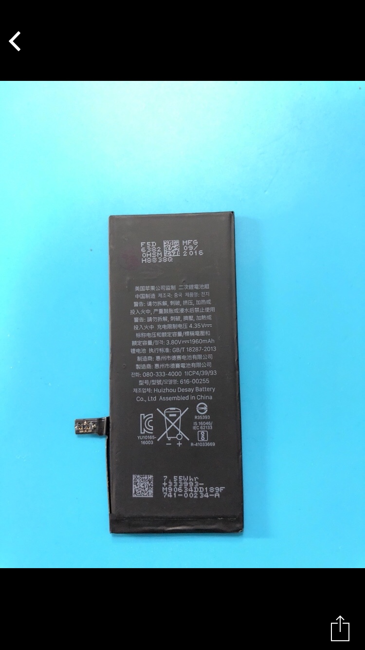

Is the performance affected? Do i need to change the battery?
Thoughts?
redo the test just make sure your iphone is not warm or hot,dont use your phone atleast 1 hour and redo the test
It was 100% charged and not used when i did the test. Almost "burn" when i did the test
New results after i let the phone almost 1 hour down...
To change or not to change the battery..?

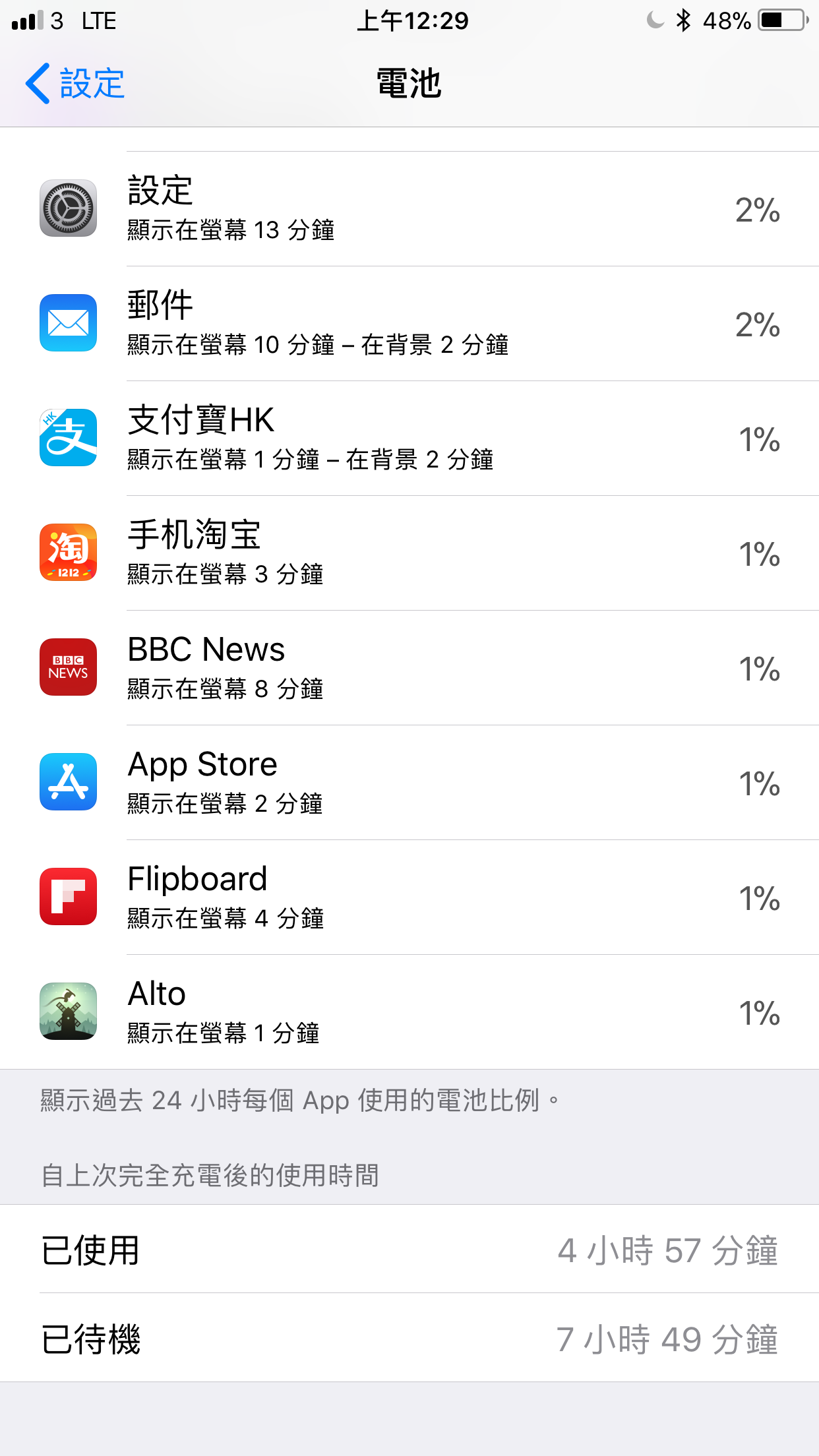

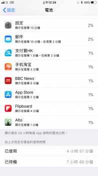

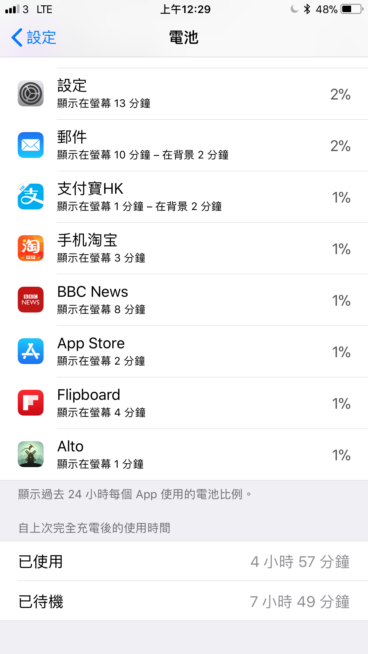

It's not normal...my battery is serious affected. Almost 3 hour of usage and 10h in standby......
you can replace it yourself or pay 79$ i dont think apple will replace it for 29$ because your iphone 7 is not throttled meaning your battery is fine apple will run diagnostic anyway
It is throttled. It's laggy.
Apple will replace your battery even if your Iphone is not throttled.

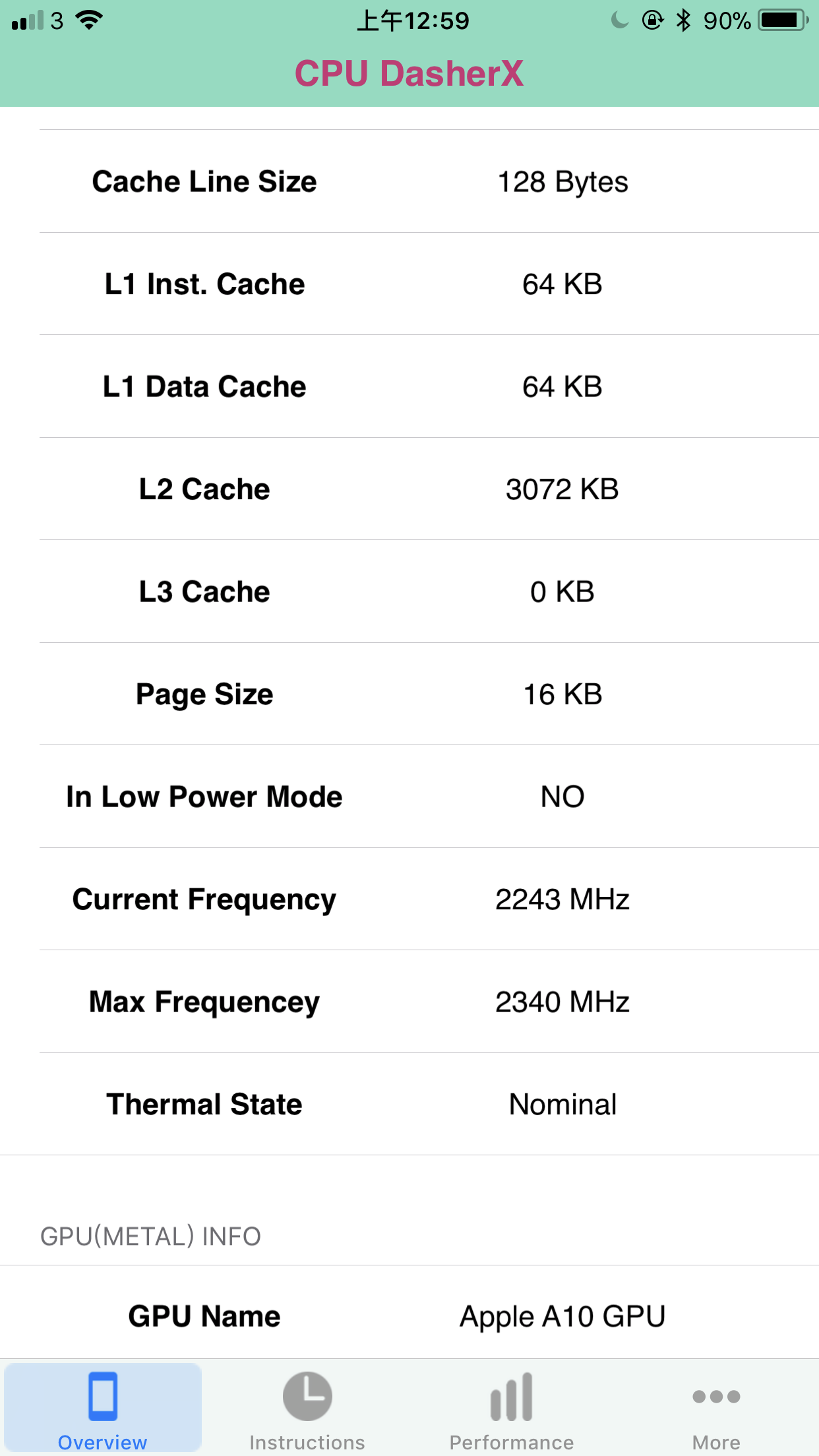

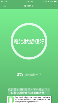

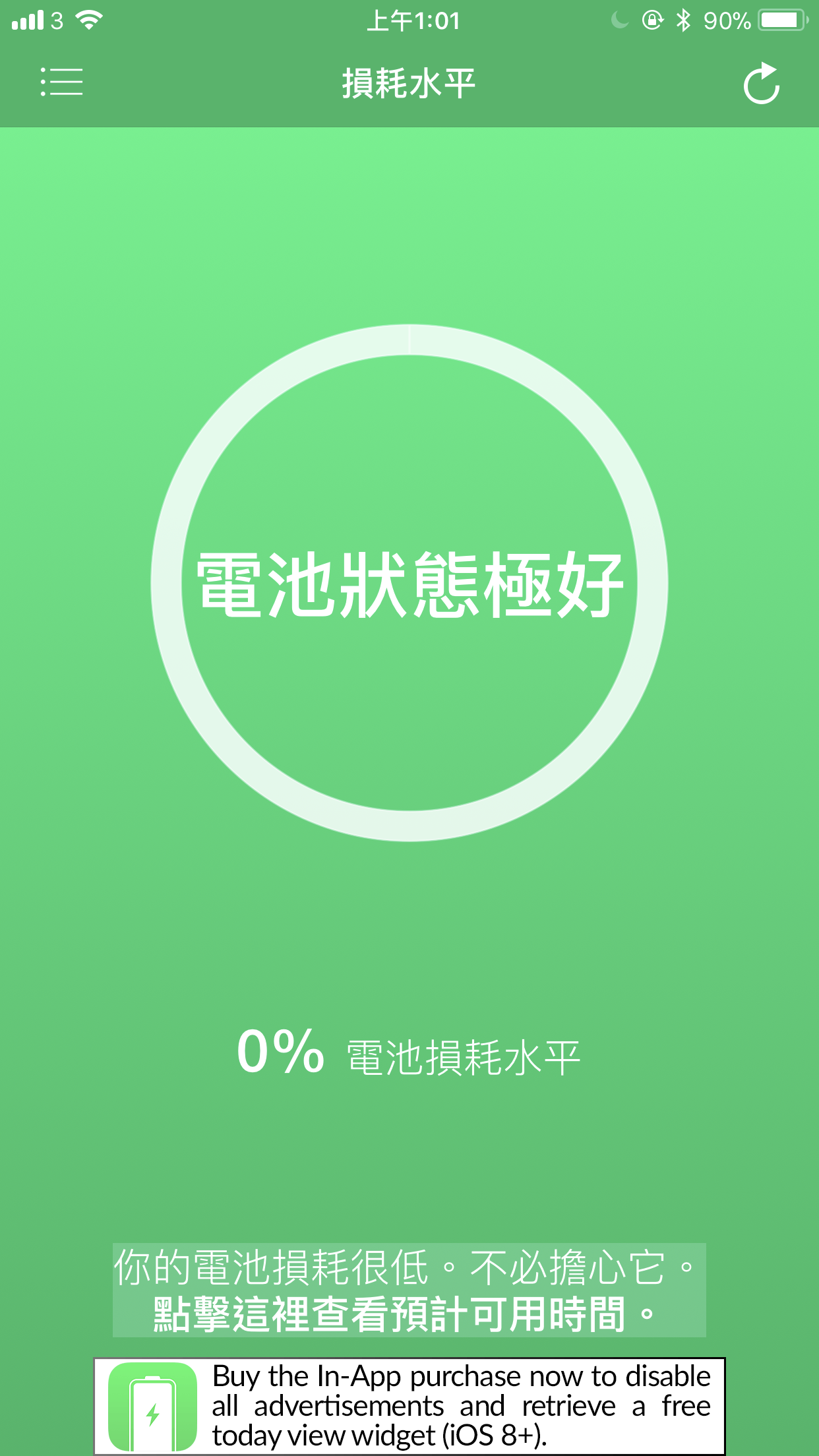

Yes, my wife 7 plus seems little bit throttled, even though the battery is excellent, 100 MHz has been declined

open many apps and then close everything except cpu dasher and check the cpu usage again.on my X i always get 2.06ghz so its lower thank yours
oh, right. Will do so
Exactly as your thoughts, the speed retains to top after closed every apps except the cpu DasherX, a good lesson to know, thanks
