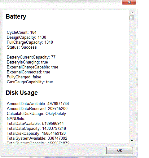

Same sort of thing happens to me although mine goes the other way and always after ive streamed radio on it, battery shows 5% think it needs charging, plug it in and it jumps to 15% within 5 seconds, thinking of just turning the percentage off, my battery stats are:
