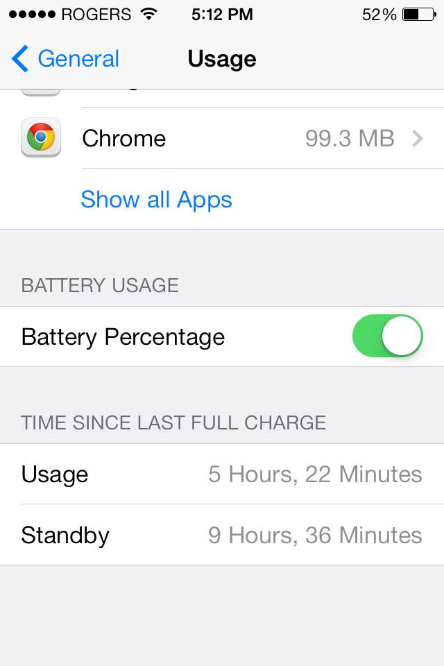

No battery issues with my 4s on 7.0.2. I don't use Safari but use Chrome instead. I also don't use icloud - I use wifi-sync with itunes. All my "use cellular data" is turned off except for apps that really need them like gmail, google maps and a weather app. Also location services are turned off except for maps, speedometer. Also turned off itunes "use cellular data"
OP: I upgraded my 4s OTA.
Here's my battery life after a calibration
So you've turned basically everything off.
