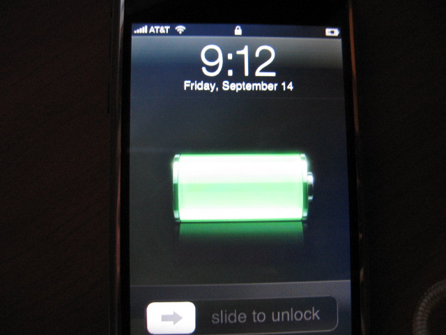

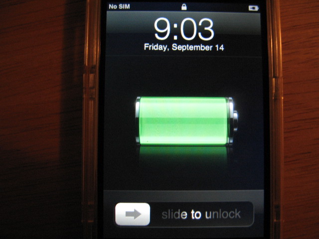

I know Im not the first person with this problem, but wondering if there is any known solution short of a return for a different one.
Got an 8gb a couple days ago. Hadnt used it that much until today, because I also have a 4gb that Ive been using. The battery on the 4gb seemed pretty good to me. Would typically be over 20% by the time I went to bed. But today the 8gb, with the same average usage I was giving the 4gb, gave me the "low battery, 20%" warning at like 3pm!!
So I come home and charge it. After about 6hrs on the charger, the plug icon is showing (has been showing since about hour 3) but you can tell there is still a percentage of the battery that is not filled.
Compare to the 4gb, it has the plug, full battery, and the glow.
Also, I noticed today the usage stats on the 8gb dont work, I assume because it wont take a full charge.
Anyone found a fix, ie restoring or something?
First pic is the 8gb that wont fully charge, 2nd the 4gb.

I had a similar issue last month. Got the little battery but not the big one. I did two restores and left the phone plugged in all night for about nine hours. When I woke up, I saw this:
Took it to the apple store with the picture as evidence and got a replacement on the spot.
Did you have to make an appointment or did you just walk in and talk to one of the reps on the floor?
I made an appointment with a genius. But it was very fast. Explained the problem, showed the picture, and he went right back and got a brand new phone and made the swap.
