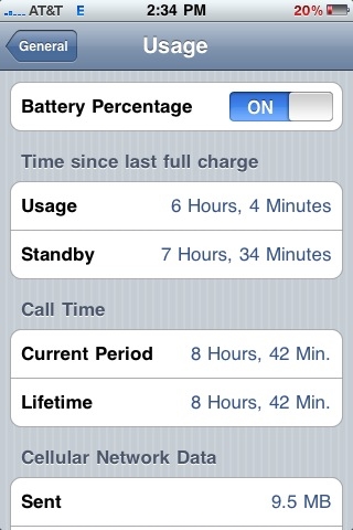

Stats of mine at 20% today, usage: 6 Hours 4 min standby: 7 Hours 34 Min
Wifi on
3G on
Push On
Fetch 15 min.
Texted like 4 times, no talk time, IM'd a crap ton -hours worth, youtubed 10 min., emailed and read about 7 times, played with a new app 10 min., browsed about an hour, and have had the IPod on all day with the exception of when I was on youtube.
I really used it alot today and fell that the 6 Hour usage time was alot. I think I could of gone about another hour or so until dead, but decided to plug it in.
I also sit in an area where its searching for service all day..

I would likely sacrifice a small fluffy bunny for usage times like those.

If your phone is constantly changing from E to 3G to nothing to whatever, then it will use the heck out of your battery.
But 6+ hours of non-iPod usage is AWESOME battery.

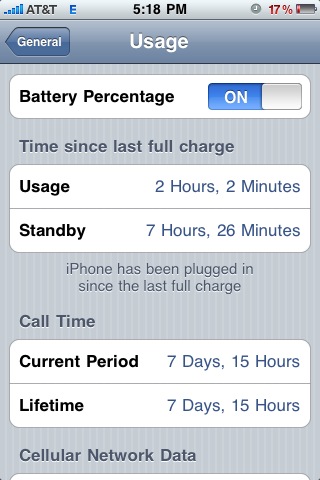

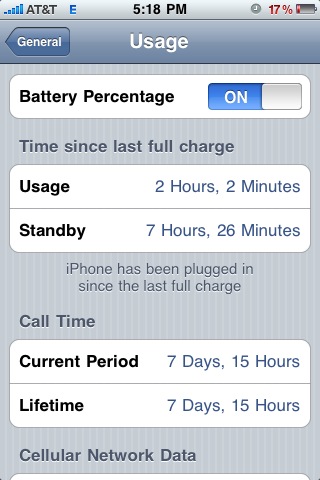

I'll raise you guys one. 3G off, Airport off. 2 hours of iPod listening (podcasts and music). 2 calls (10 minutes total), and ZERO app use. No maps, no AIM, no Facebook, etc. It's 5:30pm, last full charge was 10am (and I even plugged it into my car charger for about 5 minutes). It's at 15% now.

If you've been consistently getting 4-5 bars, that really doesn't seem right. I can sometimes get that if I turn everything on (3G, wifi, bluetooth, the works), and then spend much of the day in a place with poor signal.
