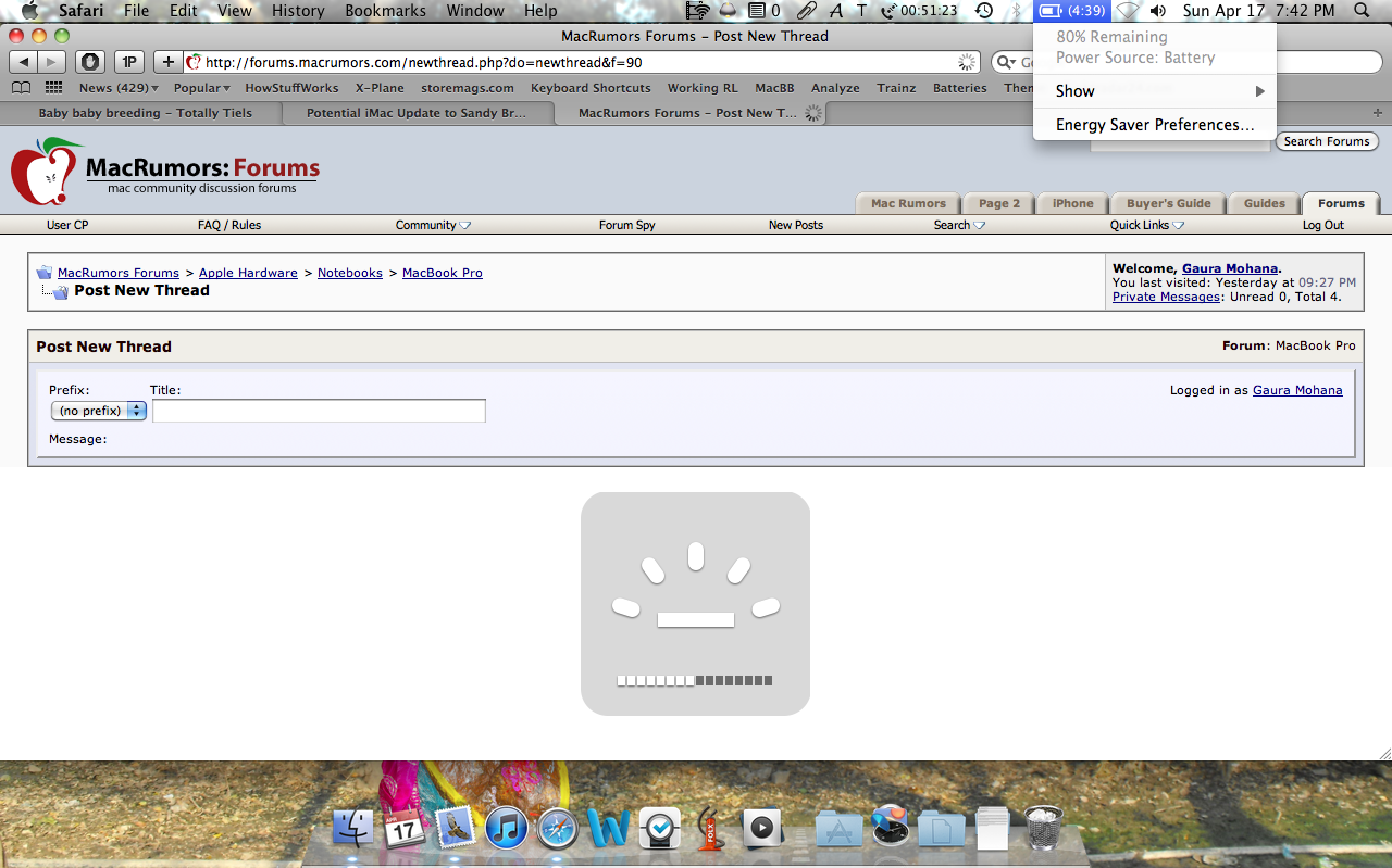

currently jumping between 3 and 5 hours
brightness at half, keylights at half
no other programs on
I no this isnt that bad - but this is a 2 month old MBP - shoudnt it be getting >7 hours running only safari with 80% battery charged?

I see from the screenshot that you are tethering instead of using wifi,I have personally experienced lower battery life via 3G than via wifi.

I am using a tata indicom plug2surf modem
btw my usage when the screenshot was taken was extremely light
Your wireless USB 3G stick will chew through power pretty readily, also get a browser that supports FlashBlocker.

Battery life takes a huge hit,while using plug 2 surf modems,have experienced it first hand.
That is primarily your source of low battery life.
Regarding the 5V,i think your right about that being maximum a usb port supplies.
The max of USB is 2,5W or 500mAmps at 5V.
It probably takes even a little less but still a lot more than you think.
You have a 60Wh to achieve 7h your notebook must use only 8.5W on average.
Now add just 1W. With 80% charge you end up with 5h.
Simply pluging in a USB stick keeps the notebook from saving energy by shutting down all the USB ports as well as putting to sleep all the responsible controllers and stuff and again it is CDMA which needs more energy than Wifi for the simple reason that it needs to transmit over much greater distance.
Also if you don't need the backlight keyboard turn it off entirely. While half/min or max backlit keyboard makes little difference. Between on and off is almost around 0.5-0.8W. It is a farily useless feature anyway. Turn on some lights that is much healthier for your eyes every eye doctor will tell you that.
