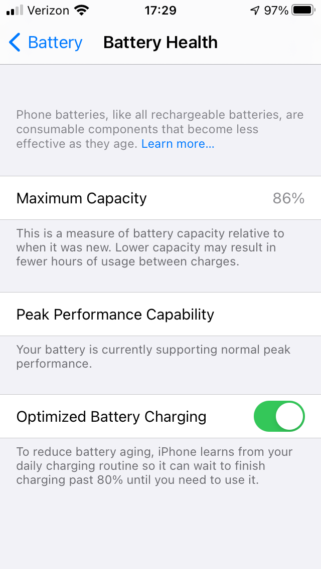

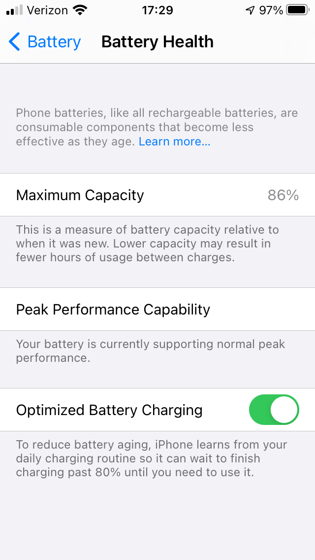

The battery was replaced some time last year and says max capacity is 86% and battery is peak performance capability. It was replaced last year.

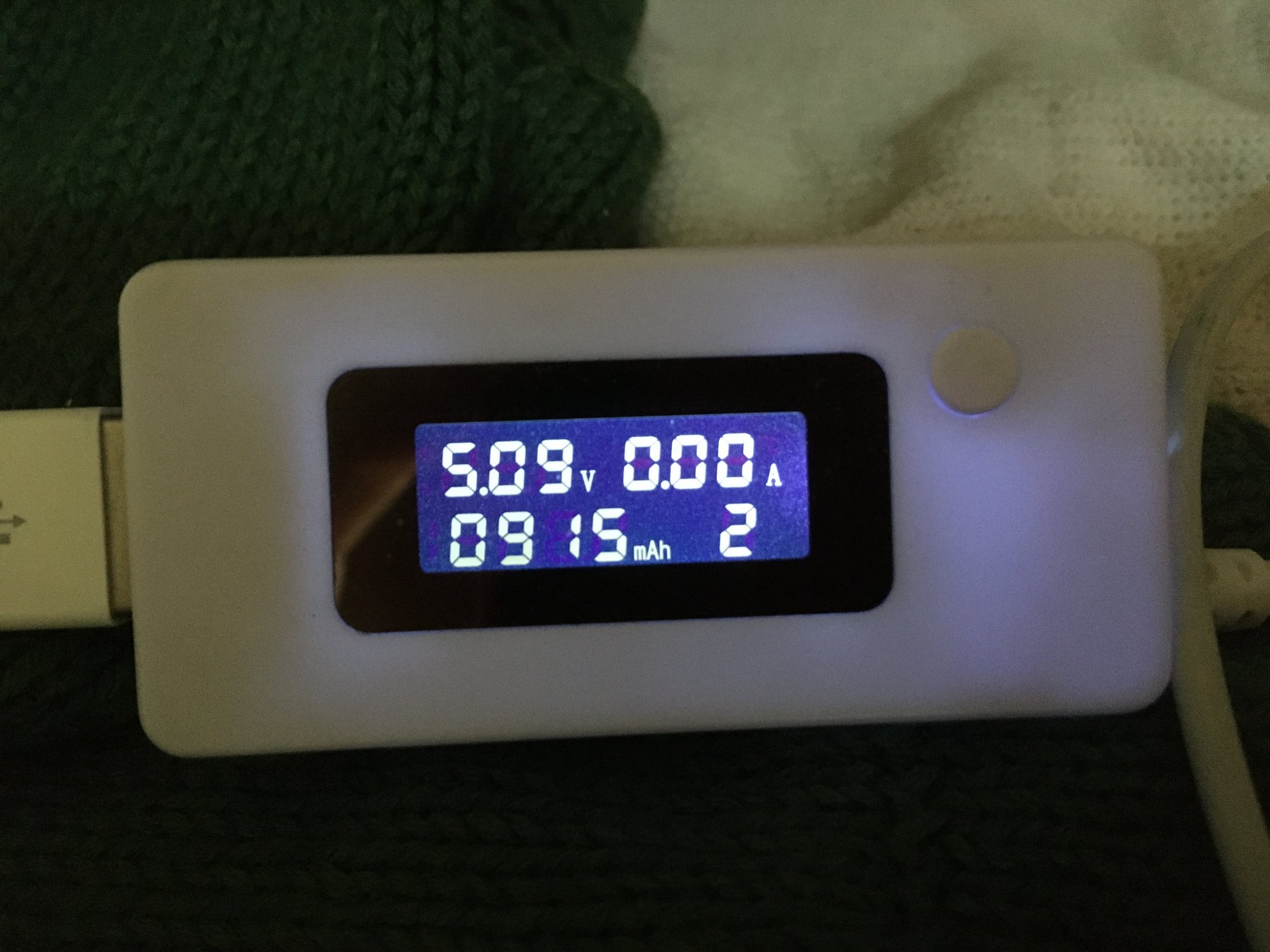

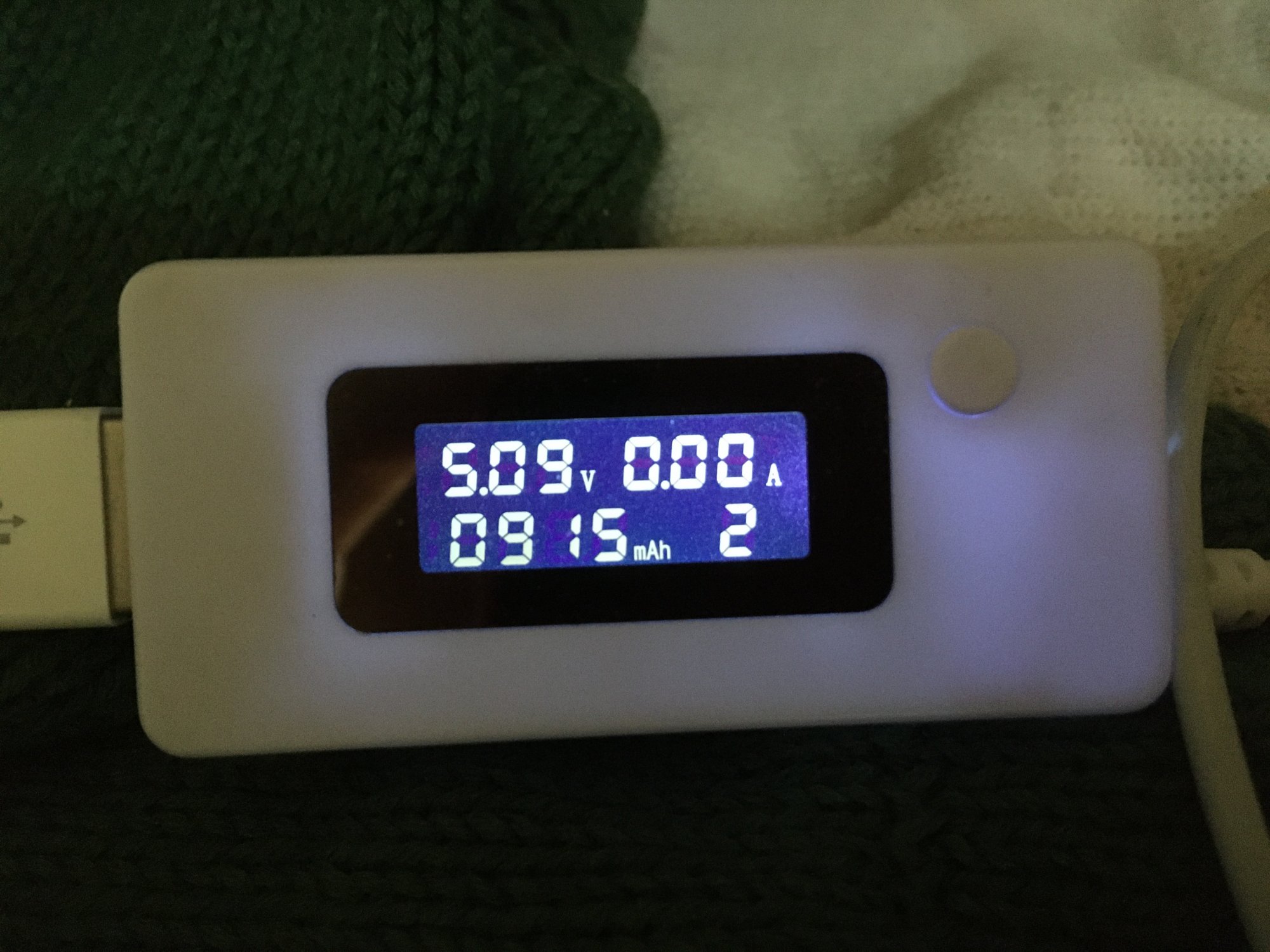

Out of curiosity, I wanted to test how much energy the phone would take in while charging. So, I let the battery run out until the phone turned off. Let the phone & battery rest for 10 minutes. Plugged in the phone to a USB battery pack with an in-line USB power meter in-between. Turned on airplane mode and let it charge until the USB battery pack automatically shut off power at full.
Design capacity for the batt is 1624 mAh. How much energy did the phone accept?....
That's right! 915 mAh only. So, that's 56% of its design capacity.
And what does iPhone Battery Health report?
Somebody is lying....
