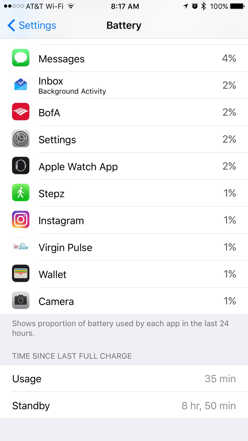

And this is my battery life today.
That is hardly a scientific test. First of all, battery life is not linear. The first 10% take longer to drain than the folllowing 90%. This is because iOS does not start draining the battery meter until the device is really at 95%.
100% reported = 95%
50% reported = 47.5%.
So your battery is not at 100% but someone in between 95-100%.
Second, your usage is different. You are connected to WiFi calling instead of cellular network which off the bat uses less battery power.
Third, I'm assuming that screenshot is you sleeping overnight. That means you have 35 minutes of background usage without touching the phone. I guarantee you if you did the same exact thing with the watch connected, the results would be the same. I wake up with 10 minutes of usage and 7.5-8 hours of standby and my phone at 100% as well.
If you truly want to see if it's the Apple Watch (I'm 100% certain it's not), then you are going to have to at least control your variables. So unfortunately that screenshot means absolutely nothing.
