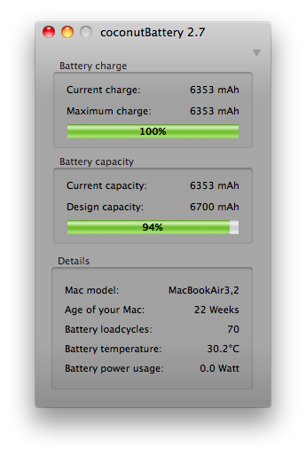

Thanks for the tip on Coconut. I installed it last night and ran it and here is what it said:

Thanks tO everyone! Since I unplugged my external drive, battery has been awesome, again!
70 cycles in 22 weeks, is it too much usage?
Should I keep it plugged more often?
When would the battery start degrading?
Under normal usage (mainly web surfing with a bit of youtube), I can't even get close to the advertised 7 hours of battery time.
These batteries are rated to retain 80% of their charge through the first 1000 cycles. Keeping it plugged in is fine as long as you use it off of the power adapter occasionally.
As for not getting 7 hours, use AdBlocker and ClickToFlash for increasing web browsing time.
I believe that you will never going to get 7 hours with youtube, but I did a test and I got exactly 8 hours and 6 minutes (50% brightness, WiFi on and working on word/excel/email and internet of course)
