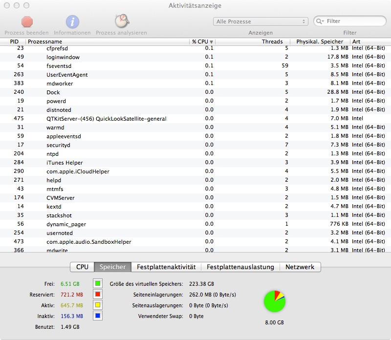

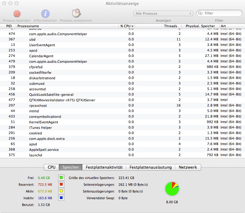

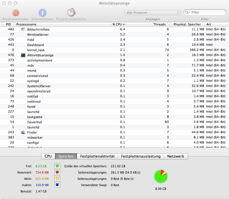

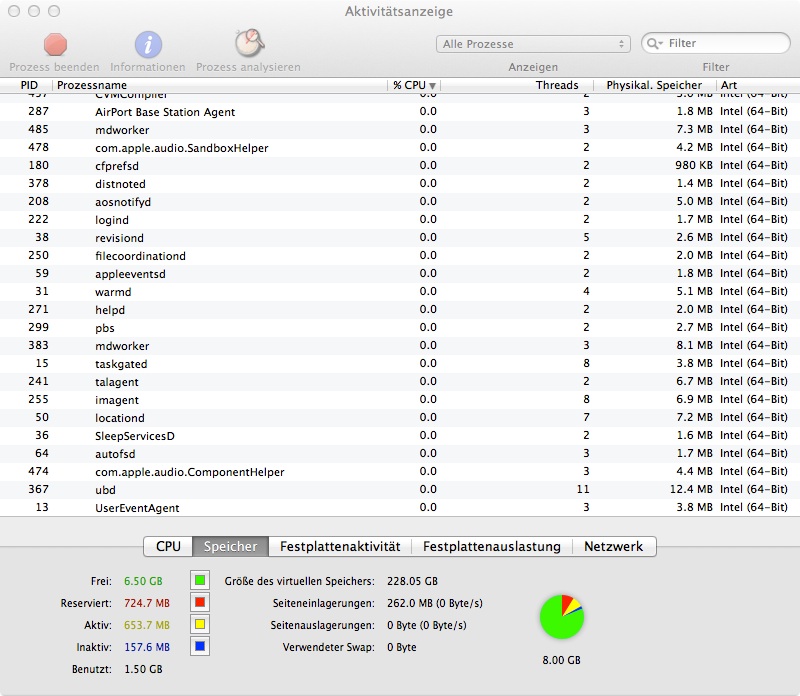

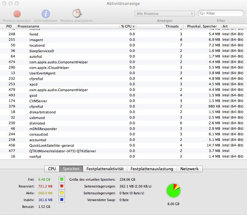

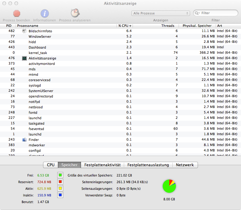

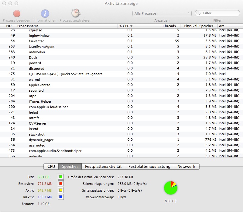

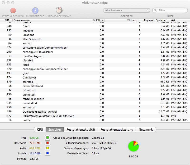

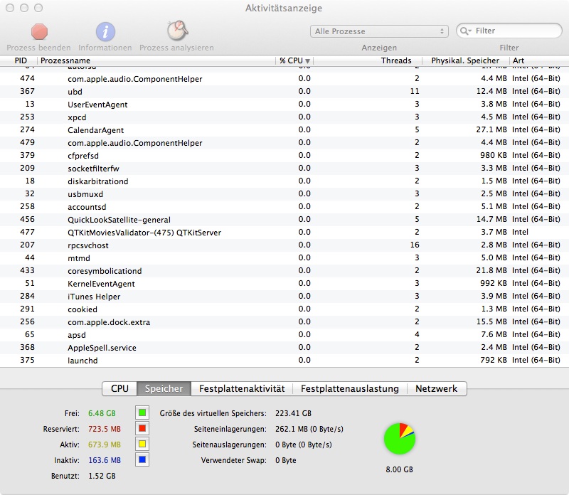

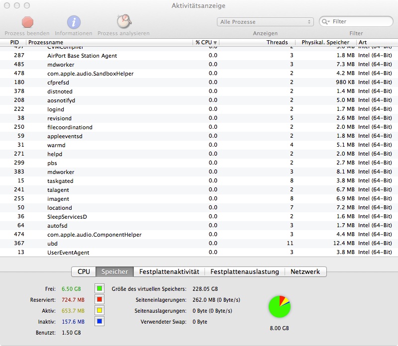

As your time remaining is a constantly-changing estimate, based on the current workload on your system, a shorter time on a full charge would indicate you have more load on your system at the moment. That, combined with the higher heat, indicates you have apps/processes running that put higher demands on your system, draining the battery faster. Use iStat Pro to get accurate readings of your temps.
  1. Launch Activity Monitor
  2. Change "My Processes" at the top to "All Processes"
  3. Click on the CPU column heading once or twice, so the arrow points downward (highest values on top).
  4. Click on the System Memory tab at the bottom.
  5. Take a screen shot of the entire Activity Monitor window, then scroll down to see the rest of the list, take another screen shot
  6. Post your screenshots.

I don't see anything in your screen shots that indicates high resource usage. What does your time remaining look like now? Remember, it changes constantly and isn't highly accurate.
